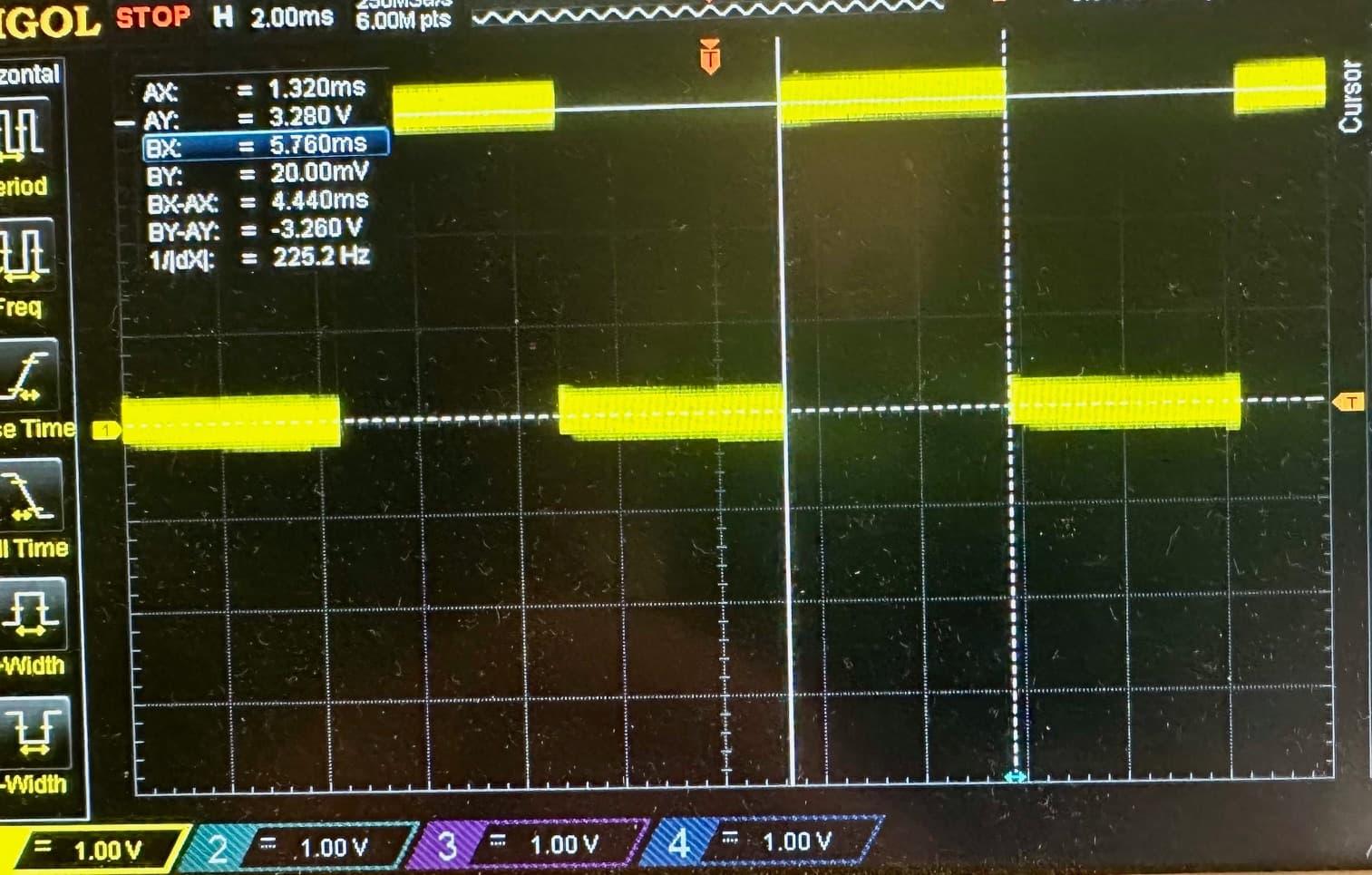

adjusting to GPIO1 : scope.trigger.triggers = “tio1”
and adjusting the sam4s_hal.c accordingly with:
void trigger_setup(void)
sysclk_enable_peripheral_clock(ID_PIOA);
gpio_configure_pin(PIO_PA10_IDX, PIO_OUTPUT_0 | PIO_DEFAULT);
void trigger_low(void)
gpio_set_pin_low(PIO_PA10_IDX);
void trigger_high(void)
gpio_set_pin_high(PIO_PA10_IDX);
gpio_configure_pin(PIO_PA10_IDX, PIO_OUTPUT_1 | PIO_DEFAULT);

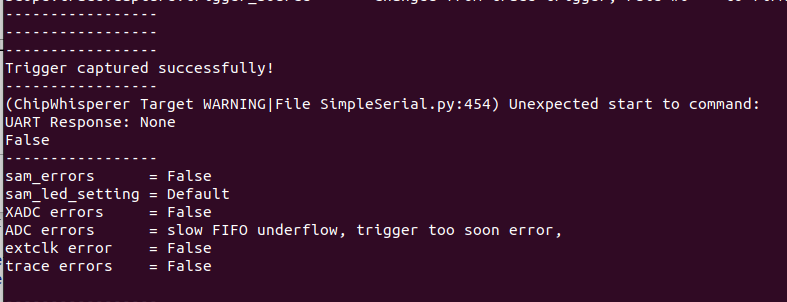

we get the triggers as expected,
→ ADC errors = slow FIFO underflow, trigger too soon error,
can be fixed i guess …
TIO1 and 2 are reserved for UART, so you won’t really be able to use those. I’m pretty convinced there’s something wrong with your Husky. Can you contact support@newae.com so that we can do a replacement?
Yes - i iknow they are TX/RX and blocking these basically renders the Husky pretty much unusable.Was just to test the theory and see if it works
Sure will do
