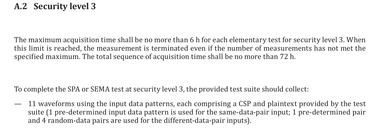

Recently, I’ve been conducting side-channel analysis following ISO 17825. However, I encountered a confusion during the Simple Power Analysis (SPA) phase. The documentation requires collecting 11 traces using different patterns, but there are only 6 types of inputs provided. Is there an issue with my understanding?
While you can use ChipWhisperer to perform ISO 17825 testing, it’s not something that we can directly support or help with.
