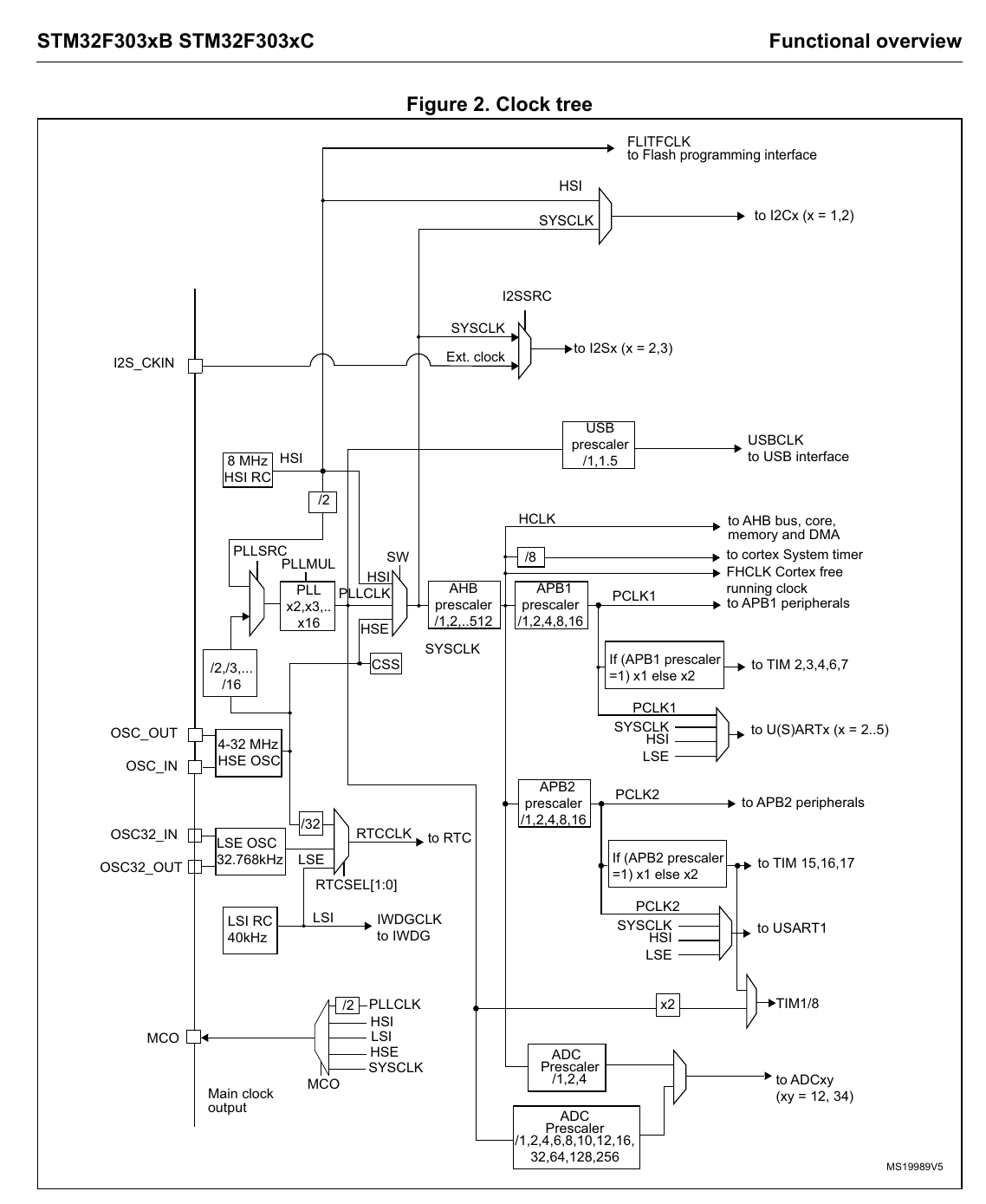

Easy- you’ve exceeded the target’s maximum clock frequency.
Wait, but according to the document, its maximum is 72MHz. Do I misunderstand something?
https://www.st.com/en/microcontrollers-microprocessors/stm32f303rd.html
From the datasheet:
“An external 4-32 MHz clock can be selected”
So yes you can configure it to run faster internally, but the externally provided clock has a limited range. These types of processors usually have lots of clocks!
