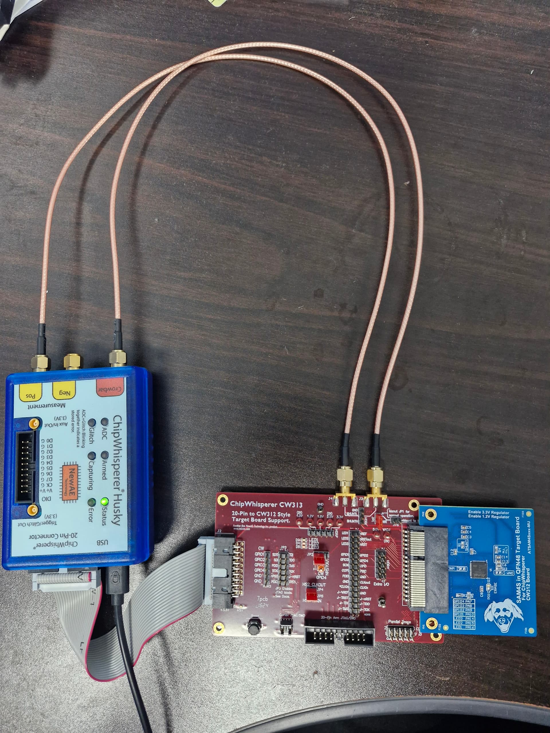

Have you connected the SAM4S target to Husky, and the 20-pin cable between the two correctly? Check your Husky user manual: there is a picture.
If it’s still not working, post a picture of your setup.
hello jpthibault
My reply was late because I had work to do.
This picture is my hardware setup.
I think I connected it correctly, but it still doesn’t work.
Thank you for your reply.

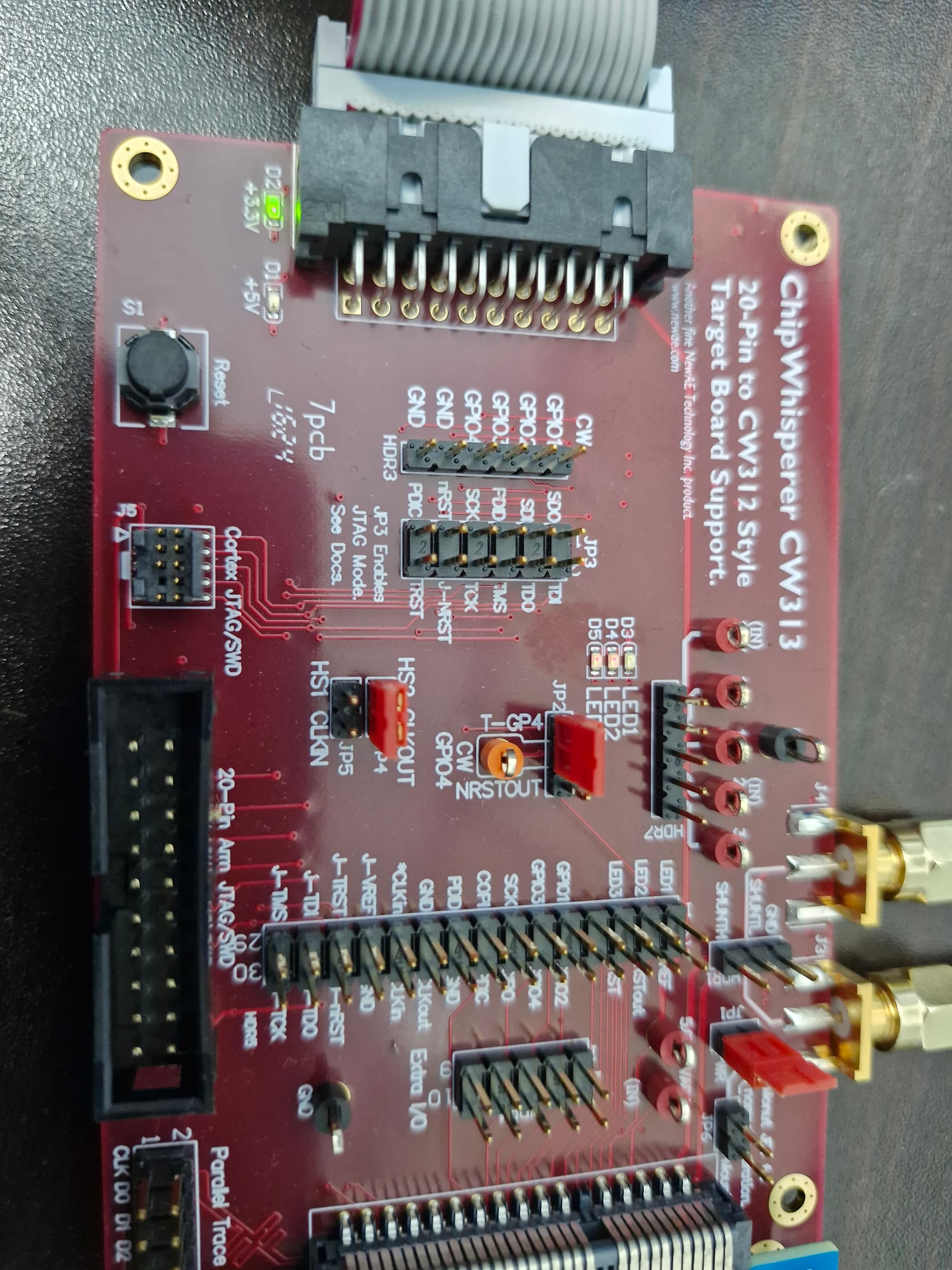

I can’t tell for sure from the picture: are any of the CW313 LEDs on?
In particular the green +3.3V LED near the bottom of the 20-pin connector.
d2, d4, d5 leds are on.
d2 is green, d4 and d5 are red.

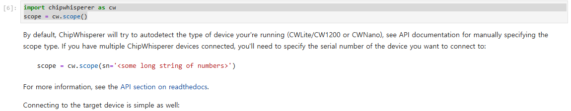

Can you set cw.target_logger.setLevel(cw.logging.DEBUG)before running the cw_program_target() command, and share the output?
Here is a output.
Did CW not recognize it?
You need to import chipwhisperer as cw first.
In the notebook where programming the target is failing, insert cw.target_logger.setLevel(cw.logging.DEBUG)after the import, but before cw.program_target().
I did it that but the return is None.
Sorry, there is a misunderstanding. cw.target_logger.setLevel(cw.logging.DEBUG) is not meant to return anything; it sets the logging level for everything that follows. Once it is set, cw.program_target() will produce additional logging that will help us understand why programming the target is failing. That’s the output I want.

In that case there may be a problem with your target board.
Email support@newae.com, with a reference to this thread, and we will send you a replacement target board.
I really appreciate your help.
Thank you so much for your help so far :slight_smile:
The solution is removing SMA calbes in my case.
