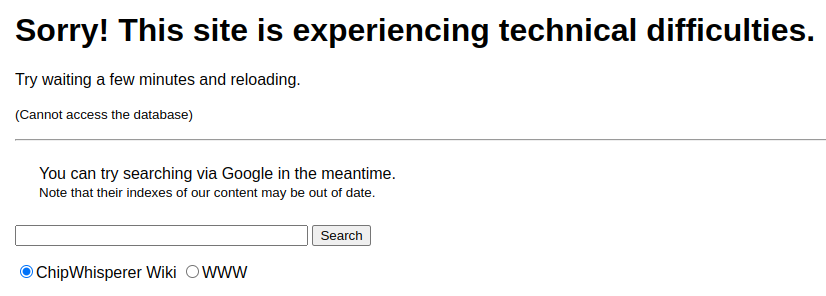

Hi. I cannot open the ChipWhisperer Wiki page since last few days http://wiki.newae.com/V5:Main_Page . The page is displaying like this as shown below.
Could anybody please support me on this? When can I access the link properly?
That site has been deprecated for a very long time. Everything is on readthedocs now.
