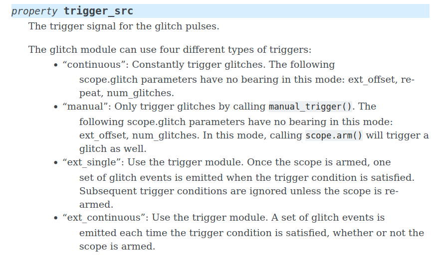

I am using ext_continuous trigger mode, what is the difference between the offset and ext_offset in this case? My understanding is that offset is where the glitch will be inserted in the clock cycle and ext offset is the clock cycles between the trigger high instruction and the cycle where glitch is inserted. Is this correct or does the ext offset replace offset in continuous mode?
ext_continuous is the same as ext_single except that the scope does not need to be armed.
offset and ext_offset are as defined. Refer to Scope API — ChipWhisperer 5.7.0 documentation
