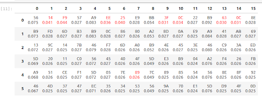

Increasing the number of traces from 15000 to 30000, 8 of the 16 key bytes could be recovered.
the leakage model used is the Hamming Distance of the last round.
Is there something else, that should be done, to recover the entire key.

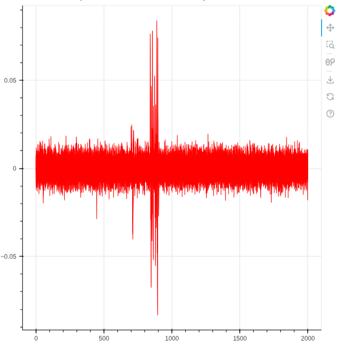

Following is the correlation plot of the guesses, with 40k traces
There is one distinct peak around the 800-1000 range, so I tried adjusting the start to 800 and end to 1000, which doesn’t help with the key bytes of 0,4,8,12.
I tried to focus on the smaller peaks, but bumping the scope.gain.db to greater than 20 leads to ADC clipped errors in CW Husky.
