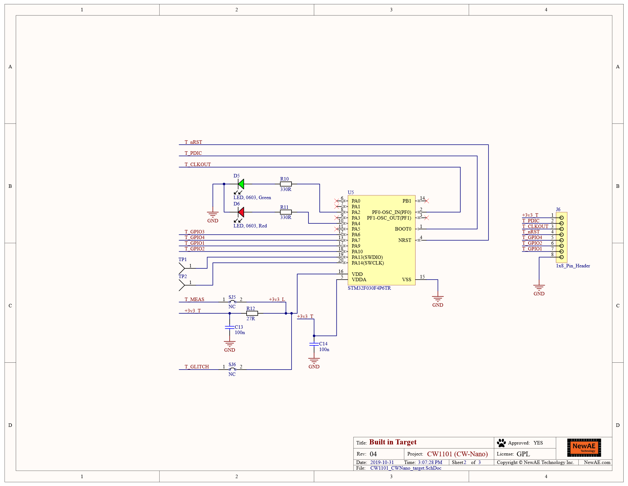

If you’re trying to use the built in target, that will be more difficult. There aren’t any SWD connection between the target and capture sides of the board, so you’ll need to connect the SWD clock and data pins, which are J_TCK and J_TMS, respectively, to pads on the bottom of the target side of the board.

Hi, yes, I am planning on using the built-in target. I currently have the Nano attached to the pins on the capture side, but no pins connected on the target side.
For clarification, what pins on the bottom side of the target board should I connect the J_TCK and J_TMS to?
Thanks!
There should be two test pads on the back of the target, labeled TP1 and TP2. J_TCK is the clock pin (connects to TP2) and J_TMS is the data pin (connects to TP1).
