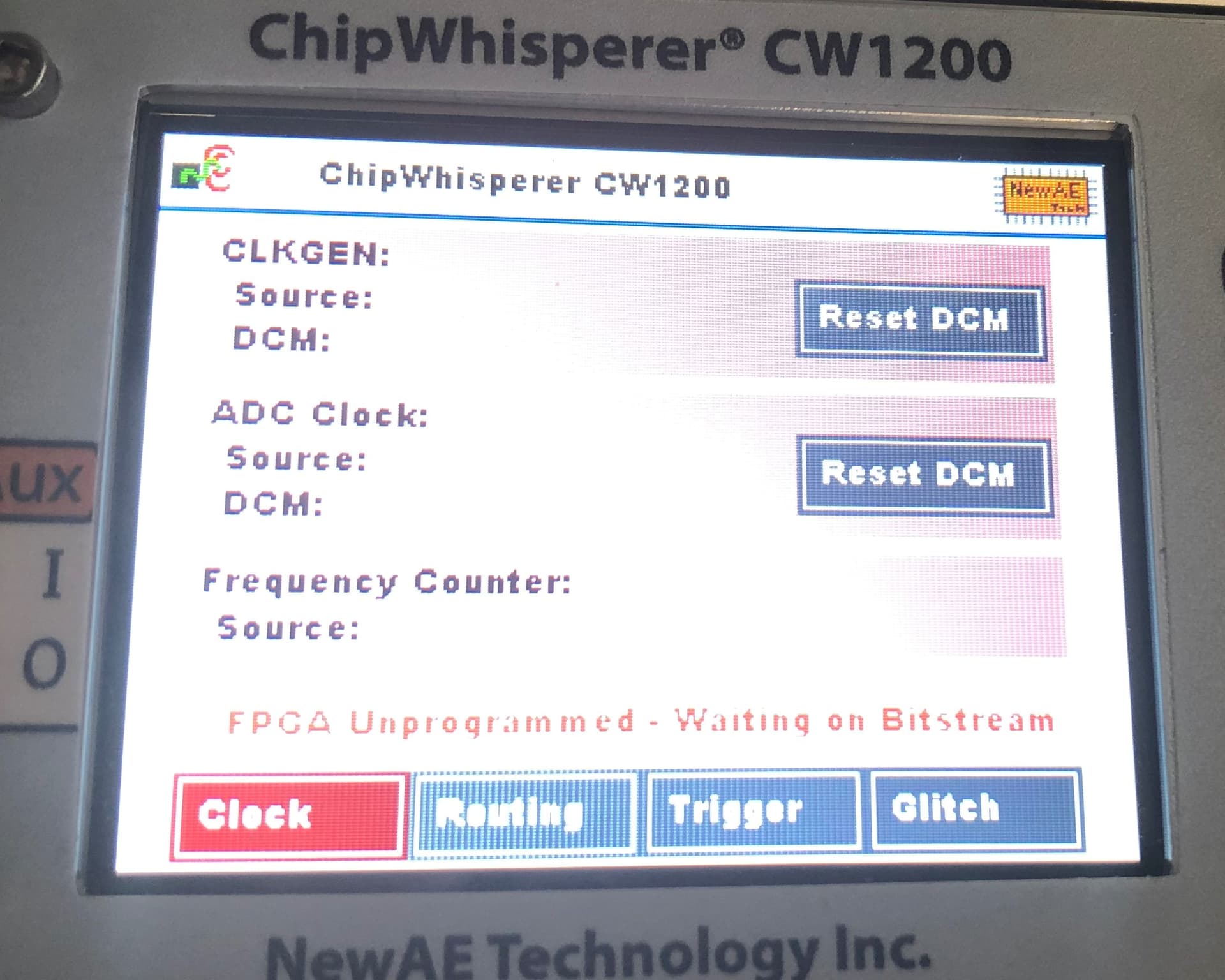

CW1200: Your firmware is outdated - latest is 1.30. Suggested to update firmware, as you may experience errors
After updating the Chip Whisperer firmware, I’m still not able to run the basic chipwhisperer commands. I am currently using the CW1200.

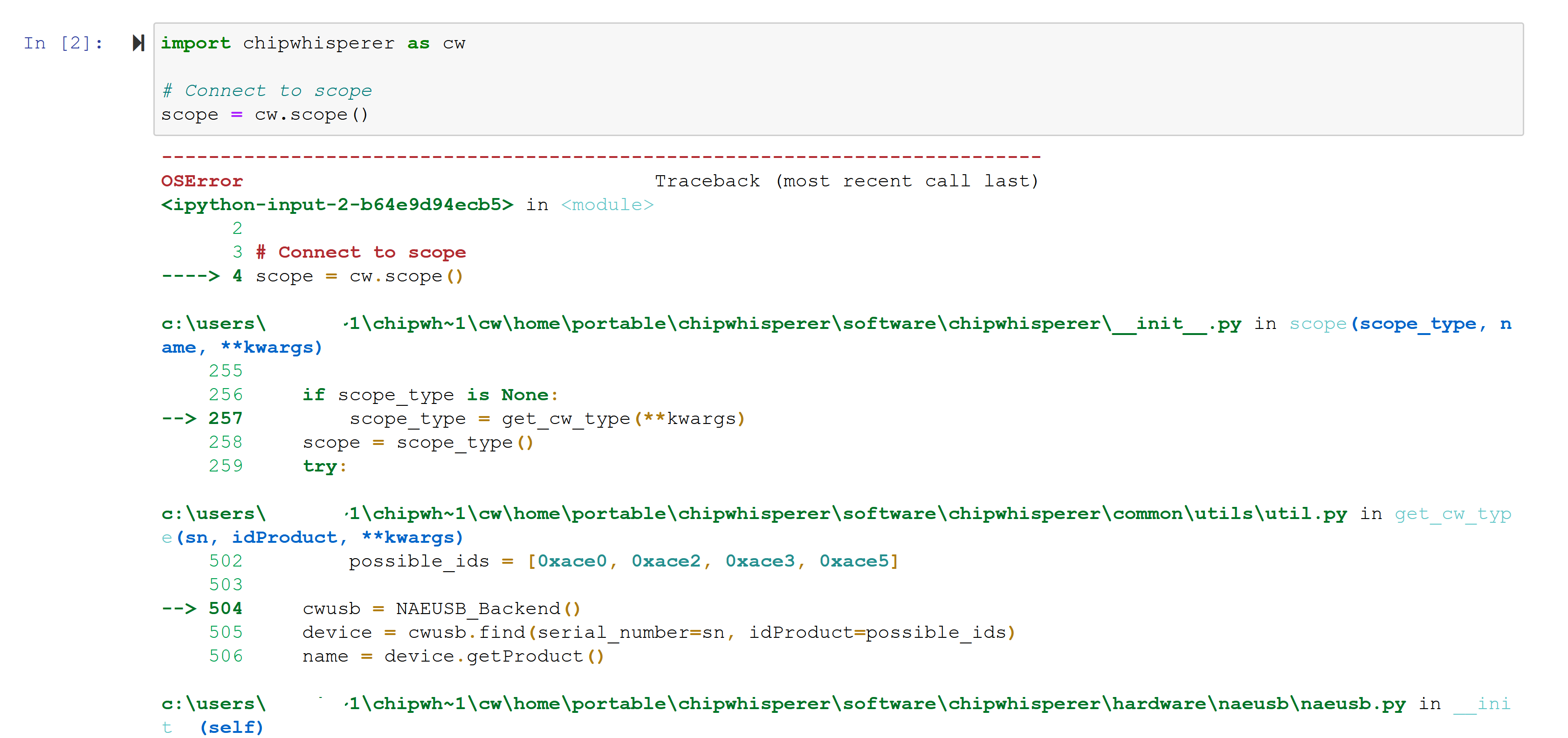

@Alex_Dewar thanks I don’t know what is wrong with the installation build. Here is my stack trace, I tried troubleshooting the errors but still wasn’t able to get anything. Let me know if a solution comes to mind.
import chipwhisperer as cw
scope = cw.scope()
OSError                                   Traceback (most recent call last)
<ipython-input-1-a074e77f8699> in <module>
      1 import chipwhisperer as cw
----> 2 scope = cw.scope()
c:\users\dolphin~1\chipwh~1\cw\home\portable\chipwhisperer\software\chipwhisperer\__init__.py in scope(scope_type, name, **kwargs)
    255
    256     if scope_type is None:
--> 257         scope_type = get_cw_type(**kwargs)
    258     scope = scope_type()
    259     try:
c:\users\dolphin~1\chipwh~1\cw\home\portable\chipwhisperer\software\chipwhisperer\common\utils\util.py in get_cw_type(sn, idProduct, **kwargs)
    502         possible_ids = [0xace0, 0xace2, 0xace3, 0xace5]
    503
--> 504     cwusb = NAEUSB_Backend()
    505     device = cwusb.find(serial_number=sn, idProduct=possible_ids)
    506     name = device.getProduct()
c:\users\dolpin~1\chipwh~1\cw\home\portable\chipwhisperer\software\chipwhisperer\hardware\naeusb\naeusb.py in __init__(self)
     89         import atexit
     90         self.usb_ctx = usb1.USBContext()
---> 91         self.usb_ctx.open()
     92         # atexit.register(self.usb_ctx.close)
     93         self.handle = None
~\WPy64-3771\python-3.7.7.amd64\lib\site-packages\libusb1-2.0.1-py3.7.egg\usb1\__init__.py in open(self)
   2173         assert self.__context_refcount == 0
   2174         assert not self.__context_p
-> 2175         loadLibrary()
   2176         self.__libusb_handle_events = libusb1.libusb_handle_events
   2177         mayRaiseUSBError(libusb1.libusb_init(byref(self.__context_p)))
~\WPy64-3771\python-3.7.7.amd64\lib\site-packages\libusb1-2.0.1-py3.7.egg\usb1\_libusb1.py in loadLibrary(libusb)
    208         with __load_lock:
    209             if not __loaded: # we were not loaded, check again under lock
--> 210                 __loadLibrary(libusb)
    211                 __loaded = True
    212                 return True
~\WPy64-3771\python-3.7.7.amd64\lib\site-packages\libusb1-2.0.1-py3.7.egg\usb1\_libusb1.py in __loadLibrary(libusb)
    217     # globals . Treat this namespace the same as the module's.
    218     if libusb is None:
--> 219         libusb = __getLibrary()
    220
    221     _libusb_transfer_fields = [
~\WPy64-3771\python-3.7.7.amd64\lib\site-packages\libusb1-2.0.1-py3.7.egg\usb1\_libusb1.py in __getLibrary()
    156         filename = os.path.join(os.path.dirname(__file__), filename)
    157     try:
--> 158         return dll_loader(filename, use_errno=True, use_last_error=True)
    159     except OSError:
    160         libusb_path = None
~\WPy64-3771\python-3.7.7.amd64\lib\ctypes\__init__.py in __init__(self, name, mode, handle, use_errno, use_last_error)
    362
    363         if handle is None:
--> 364             self._handle = _dlopen(self._name, mode)
    365         else:
    366             self._handle = handle
OSError: [WinError 126] The specified module could not be found

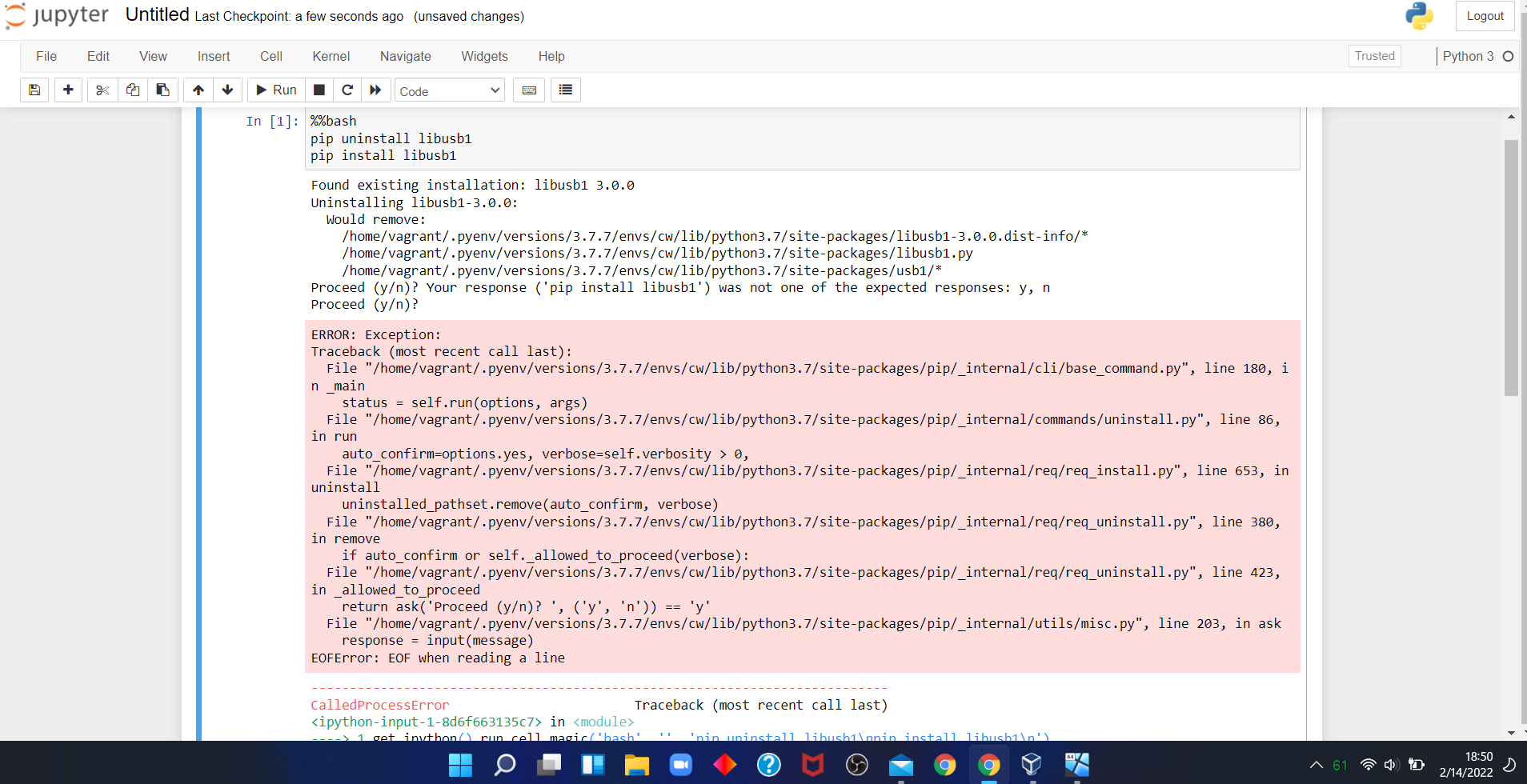

Greetings,
I have the identical problem. After looking at this page, I tried @Alex_Dewar’s solution by using libusb codes. After that, I got these messages-please see photos attached. Please help me out in this regard.
Thank you,
Whoops, sorry, forgot pip asks for confirmation. Try doing pip uninstall -y libusb1 and pip install -y libusb1.
Alex

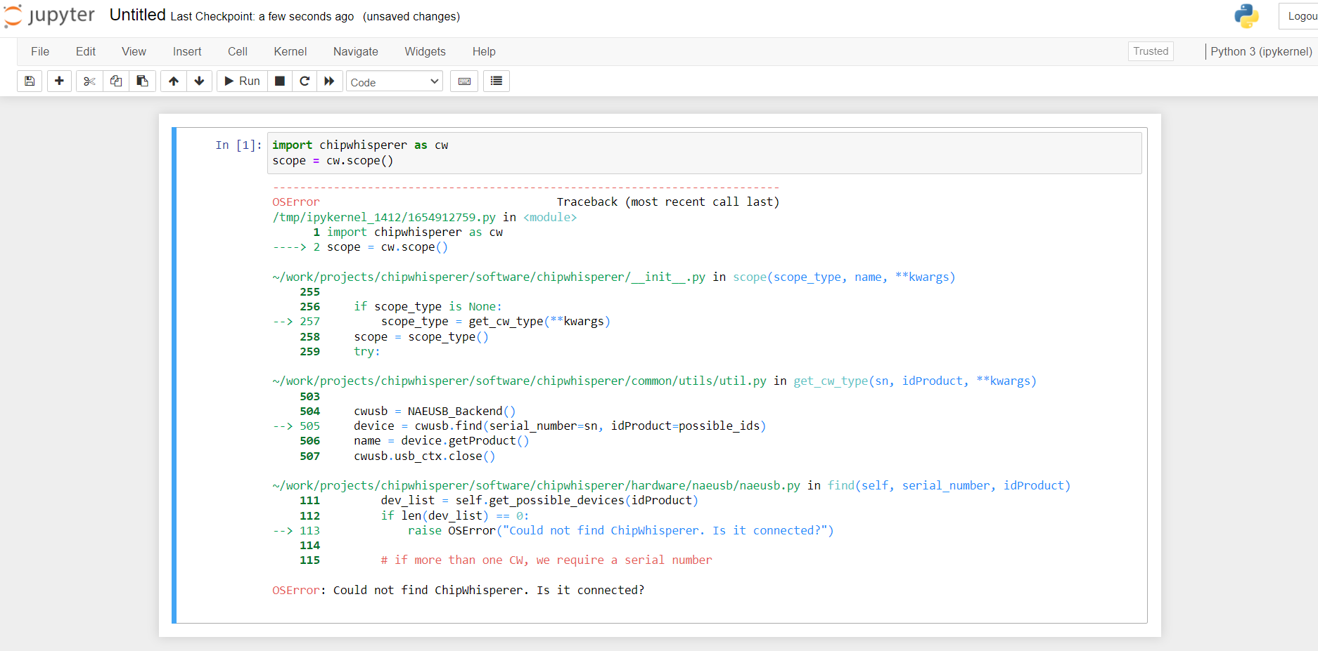

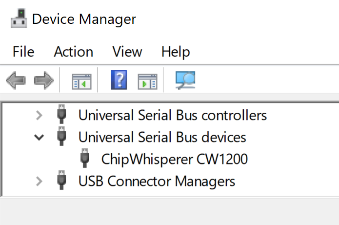

Hi @Alex_Dewar ,
After trying your idea, a connection problem occurred. Therefore, I ran Zadig.exe and successfully installed the usb driver. After that, the device manager showed the virtual box usb, which is my cw1200, in the Universal Serial Bus Devices part. However, I still get a connection error and cannot eliminate the screen on the capture tool that @fuzzingdolphin uploaded here. Please help me in this regard. Note that I installed the Blackhat 2021, which is chipwhisperer 5.6.0. Thanks in advance.
