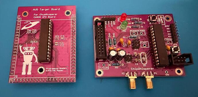

CW304 Notduino / CW308T-AVR on ChipWhisperer-Husky Plus
A short field guide after getting the ATMega328P targets (CW304 Notduino and CW308T-AVR) capturing on a Husky Plus. A few of these cost me real time….
Build platform. Use PLATFORM=CW304. It is the ATMega328P / Notduino platform and it also covers the CW308T-AVR
Programmer. Select the AVR programmer explicitly: prog = cw.programmers.AVRProgrammer
