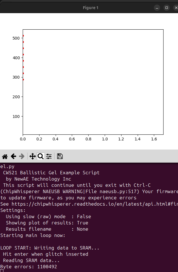

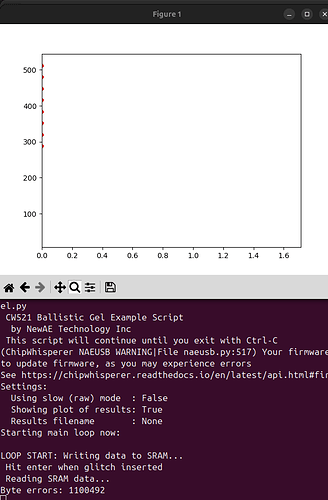

Hello,
I am currently using the ChipShouter in combination with the CW521 Ballistic Gel Target, and I am not getting the expected behavior. No matter at which location I inject the code it is plotting exactly eight faults at these locations, even though the number of byte errors is quite large. I believe my firmware is up to date (updated as shown in GitHub - newaetech/ChipSHOUTER-ballisticgel: ChipSHOUTER Ballistic Gel · GitHub, nevertheless it is still showing the warning…)
Any guidance would be appreciated.
Thanks for the report on this. I’ll take a look and see if I can replicate
