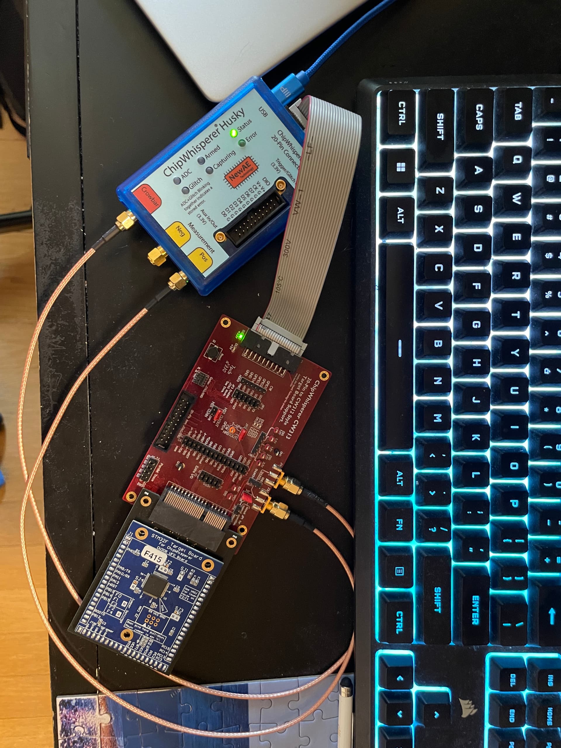

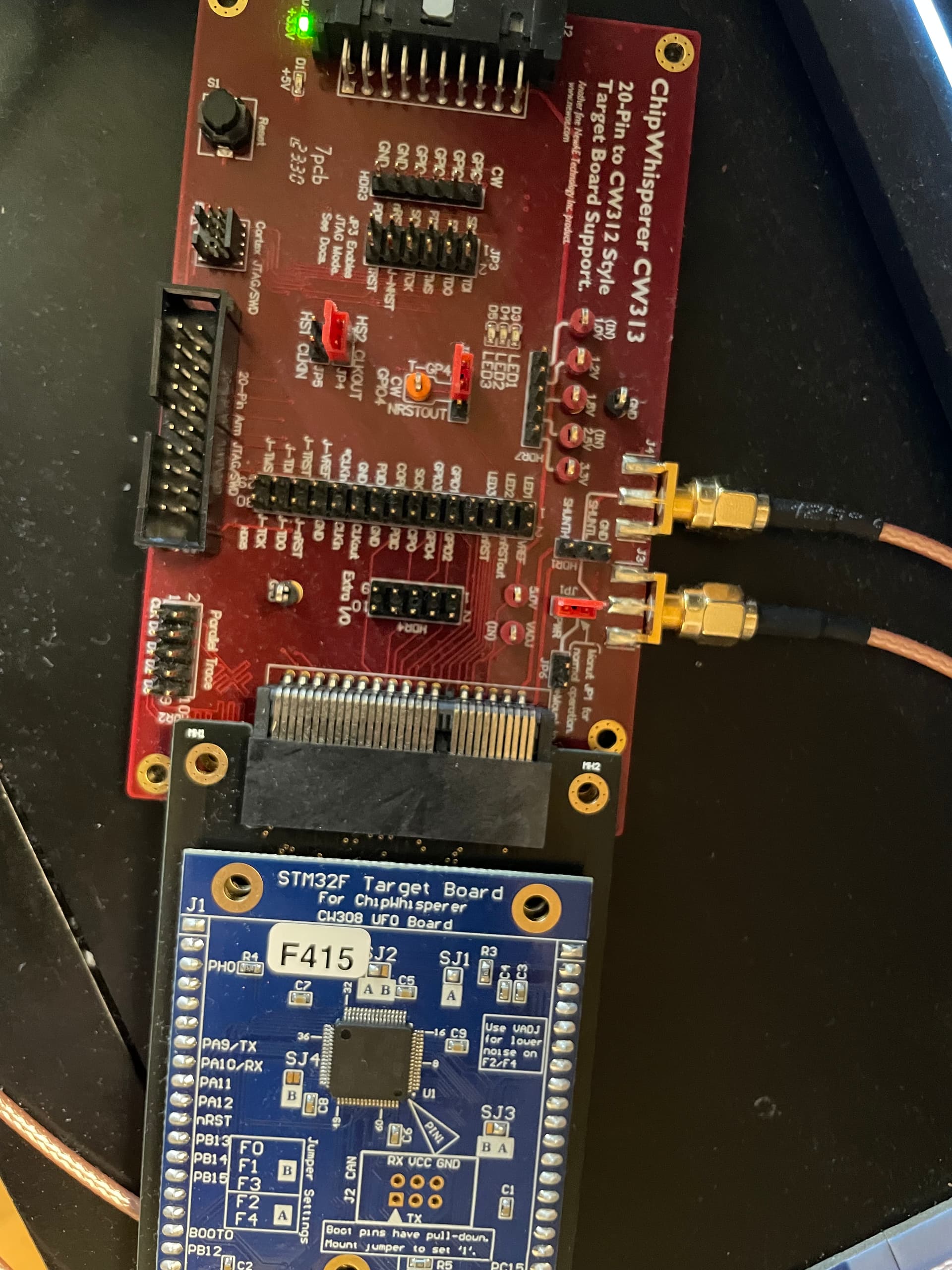

Which STM32 target are you using, and can you post a picture of the setup.
Yes here some photos of the setup and i used the stm that came with the kit for the husky

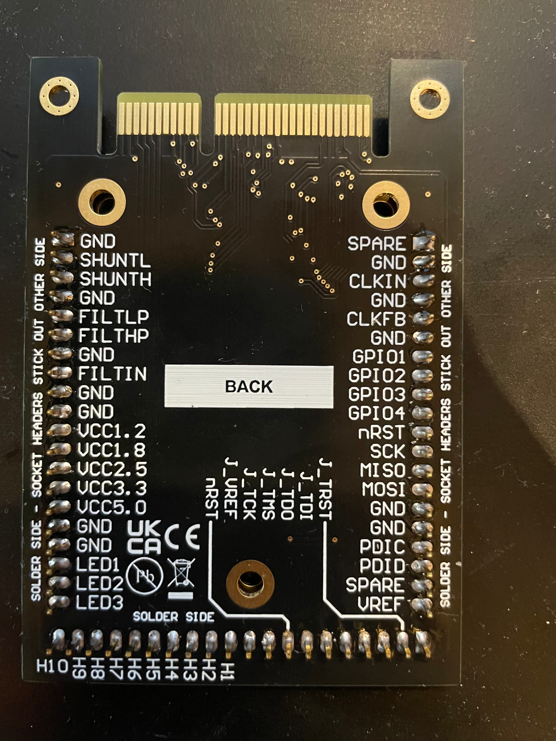

Can you post a picture of the solder connections on the bottom of your adapter board?
I found one fault solder connection and i fixed that but still when i try to communicate with the target i get this error

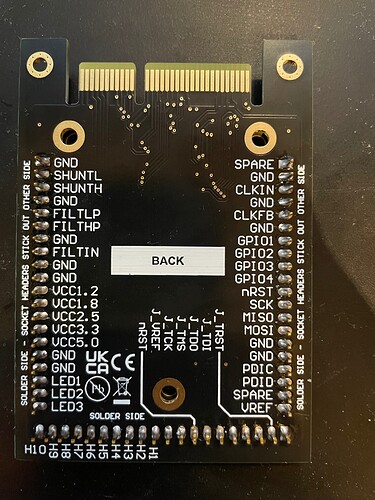

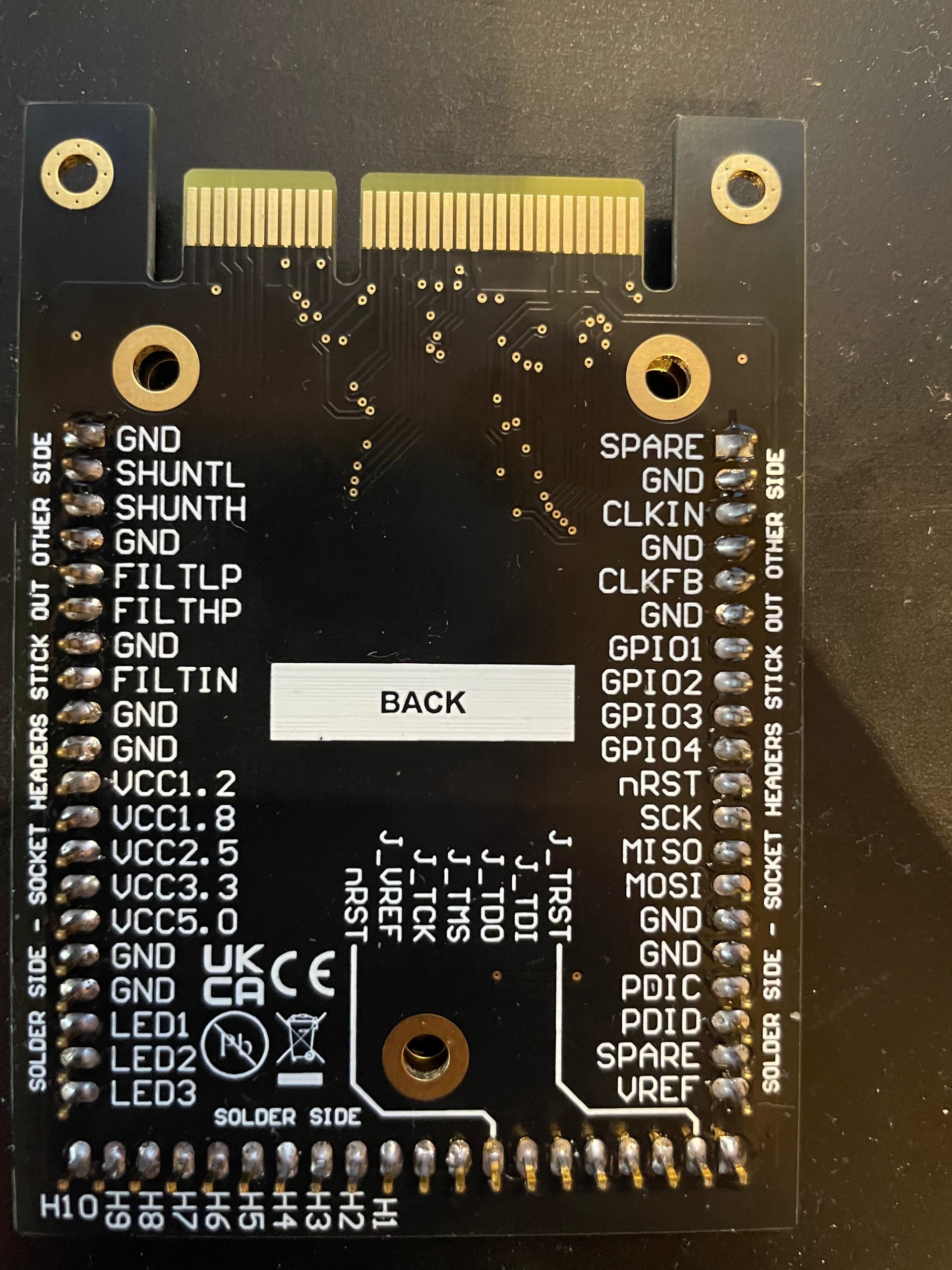

You’ve not posted the picture we requested. Most likely you have a bad connection on the I/O lines.
Here some photos of the solder side

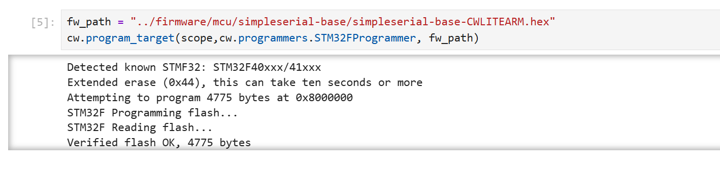

Did you successfully program the STM32F4’s firmware? What is the output of the cw.program_target() call?
Also, try simply resetting the target after it’s been programmed.
yes i successfully programmed the stm as shown bellow. also i tried reseting the target but still no result
You haven’t programmed the correct firmware. The CWLITEARM is for STM32F3 boards, while you have an STM32F4. You need to clone the chipwhisperer-fw-extra submodule in firmware/mcu/hal/ and build with PLATFORM=CW308_STM32F4.
