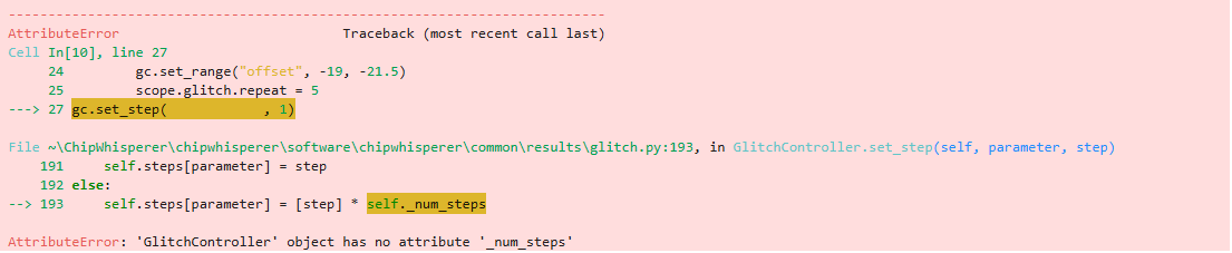

Hello, new user here and I am going through the fault injection tutorials and have come to an error I am getting for the solution notebook for SOLN_Fault 2_2 - Voltage Glitching to Bypass Password. The error I am getting is in the 10th code block, which I will put below as well as the error output. Essentially it is an error with GlitchController, and I have not had any luck debugging.

gc.set_step("ext_offset", 1)
