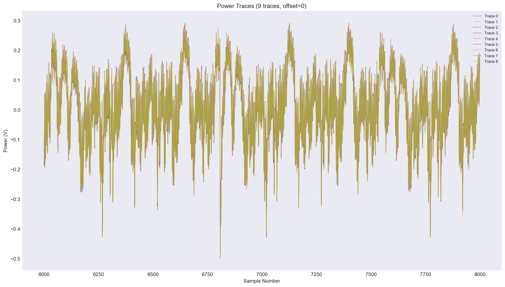

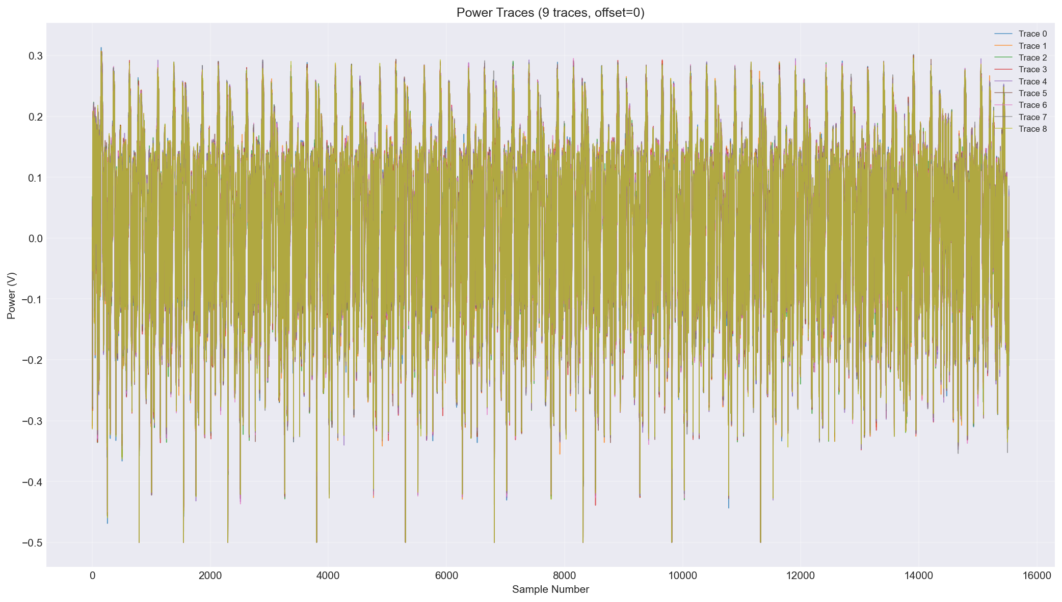

The DES power traces I captured:
  1. Complete traces:
  1. Zoomed in:
Next steps are write the leak models and scan the whole range for potential leakages to run the CPA attack there.

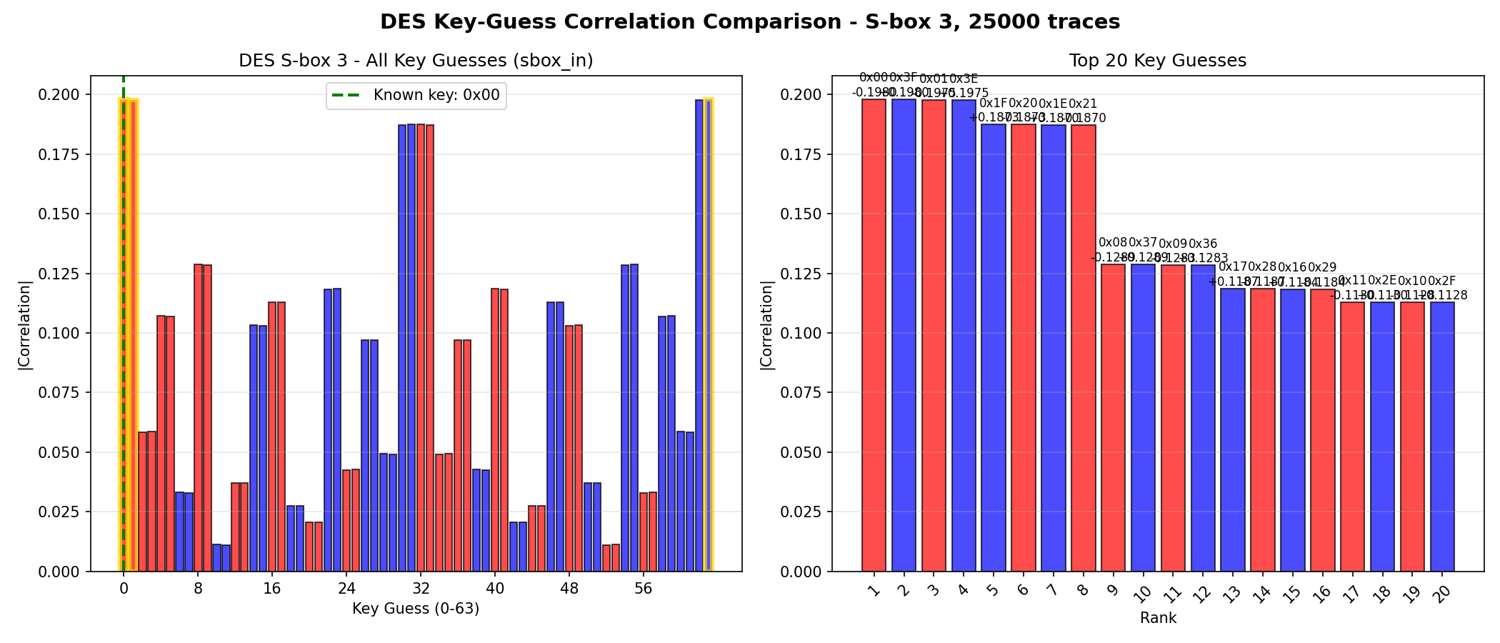

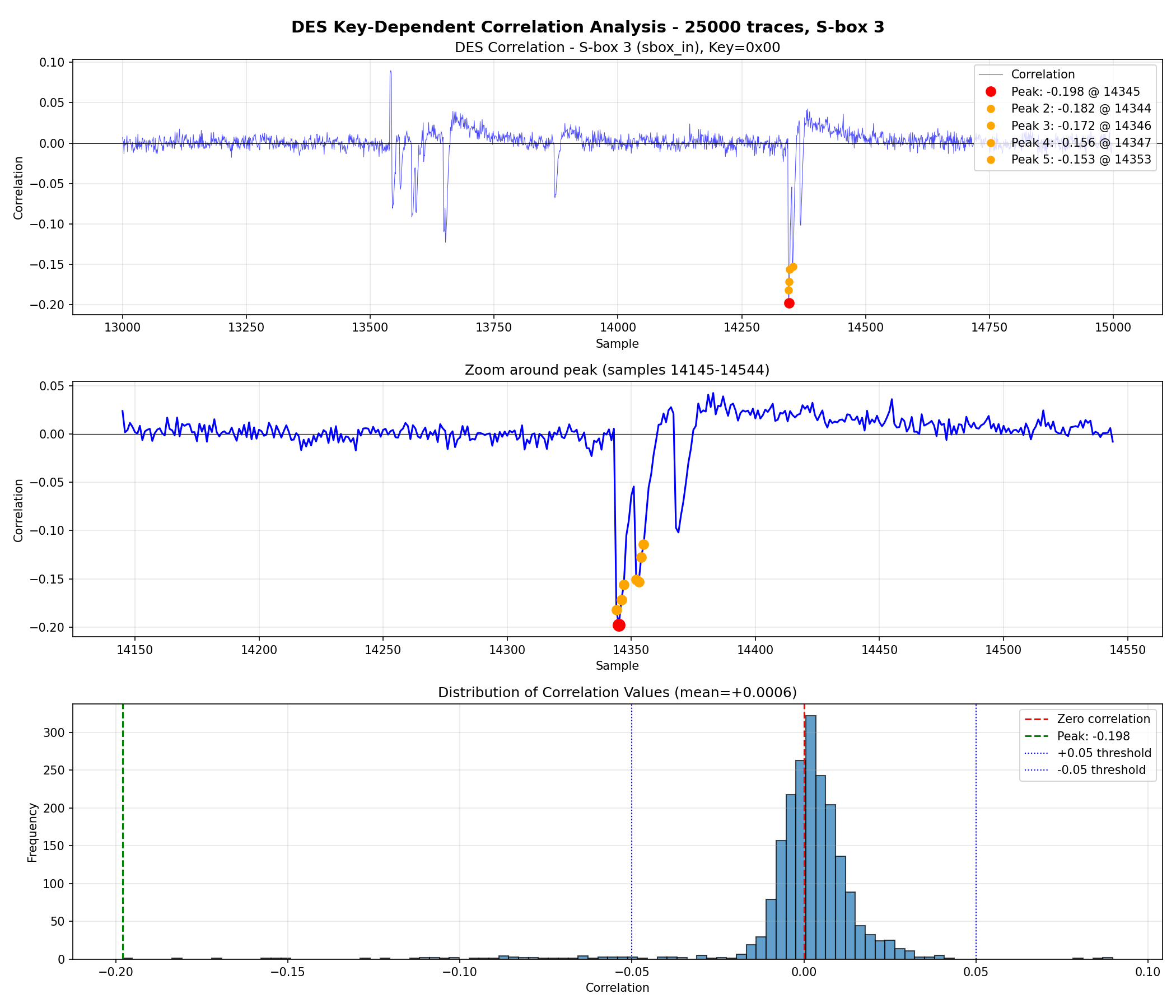

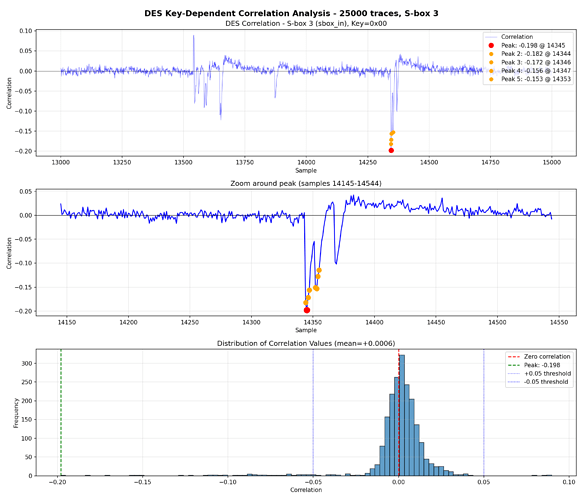

First results look promising. Same, as in AES, Pearson correlation is negative. Strong leakage happens before Sbox in.
And here is the rank of all subkeys
0x00 and 0x3F are complementary, hence they have the same correlation value. But as PSOC62 has negative correlation for the correct subkey, 0x3F can be rejected.
Top 10 Key Guesses (by |correlation|):
 Rank | Key (hex) | Correlation | |Correlation|
   1. |   0x00    | -0.198042 | 0.198042
   2. |   0x3F    |  0.198042 | 0.198042
   3. |   0x01    | -0.197494 | 0.197494
   4. |   0x3E    |  0.197494 | 0.197494
   5. |   0x1F    |  0.187288 | 0.187288
   6. |   0x20    | -0.187288 | 0.187288
   7. |   0x1E    |  0.187029 | 0.187029
   8. |   0x21    | -0.187029 | 0.187029
   9. |   0x08    | -0.128866 | 0.128866
  10. |   0x37    |  0.128866 | 0.128866
The interesting thing, the DES itself almost at the end of the trace? But what is before? DES key schedule? But it shouldn’t be so long.
