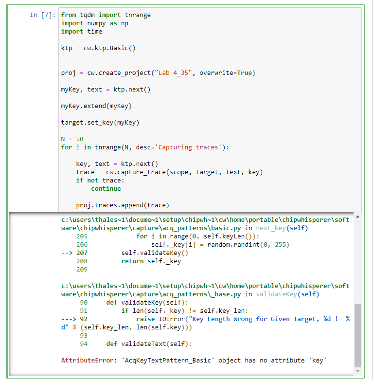

I changed the defult key in aes-independant.h to a 32 bit key. I’m not sure if this alone will be able to run AES256.
I also tried to extend the key with key.extend(key). but got an error message.
I have a hard time wrapping my head around what exactly ktp is doing. It is creating a bytearray for the key and text. Why do I need this and why is it generating a lot of keys when I am only interested in one key (the unknown key) I am looking for?
Maybe a dumb question but I would apriciate an explination on capturing traces and ktp.Basic()
Best Regards
fridthoy

It seems like my results after attacking is only dependent on the key set in aes-independant.h… at least my answer when attacking is this key. The key I send in with ktp.next() seems to have no impact, how can this be?
target.set_key() does check if the key you’re sending is the same as the last one, mostly to increase capture speed in the loop. Can you try using target.simpleserial_write('k', key) directly?
Alex
hmm, I tried using target.simpleserial_write('k', key) but it seems that the key is only dependent on the key written in aes-independant.h.
At least if I change the key in aes-independant.h the attack returns correct key. Changing the key with target.simpleserial_write('k', key) or sending a new key to the cw.capture_trace(scope, target, text, key) dosent seem to do anything, how can this be?
