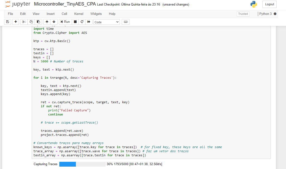

Hello everyone, I’m doing tests with the chipwhisperer 308 UFO Board but I’ve some problems. When I do the test with TinyAES I can extract the traces without problems, so I try to do some tests with secAES128 and just I can extract if I put my hand on the cable when I execute the code. I upload the video when I do these experiments and here are the link: https://youtu.be/VVqpCh6mnDY

I change for TinyAES and works very well, and when I change to this AES not work as well. Before it’s working fine and now I need to do this. I change the cable and the scope everything I can to do I do it, but now I don’t now

Look for utilizing on TinyAES, works fine with no touch hands hauahuauh
