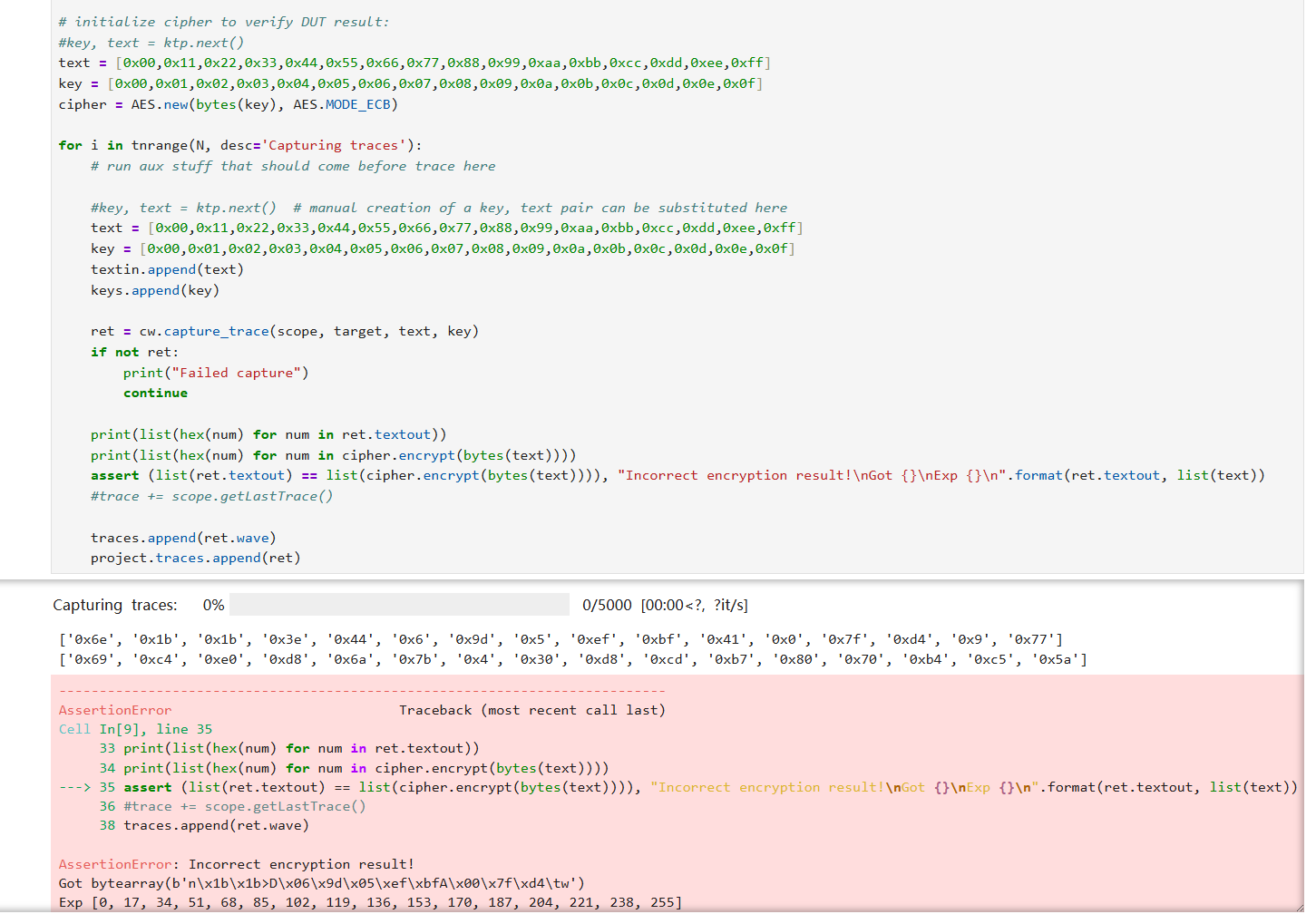

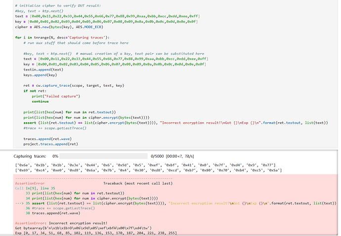

error when running PA_HW_CW305_1-Attacking_AES_on_an_FPGA.ipynb
I followed all the directions provided. I used the provided bitfile and verilog header, and I keep all the switches on the board in their default states. I used the correct TARGET_PLATFORM. But I got the error “AssertionError: Incorrect encryption result!“
I used fixed plaintext and key to make comparison: (I haven’t made any other changes besides this, and I checked out hdl with iverilog. I couldn’t find out the reason, very confused)

If I use random plaintext and key input, the wrong output is still the same. Whatever the plaintext and key is, the textout doesn’t change
I restarted Chipwhisperer and Jupyter Notebook, and this demo works well.
I’d also compare your output against a known test vector step by step. If the result starts differing after a particular round, it’s much easier to pinpoint whether the issue is with the key setup, byte order, or one specific operation rather than the whole implementation.
