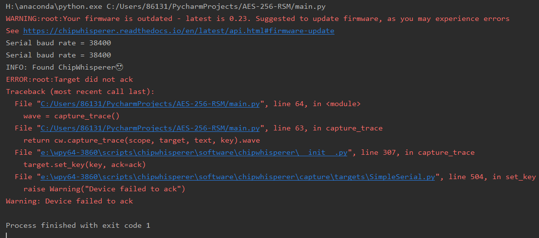

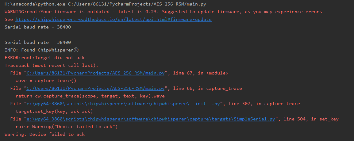

I use chipwhisperer on pycharm.I have updated the firmware of the chipwhisperer lite with cw_firmware_updater_5_4_0.exe. Why do the warnings and errors in the figure appear?looking forward to your reply,thank you!
Biyuanqiao
My first guess is that the target isn’t running. Can you try:

Alex
Can you modify your code such that only the setup is done + the code I posted above? I’m guessing the target isn’t running properly. Are you running custom firmware?
