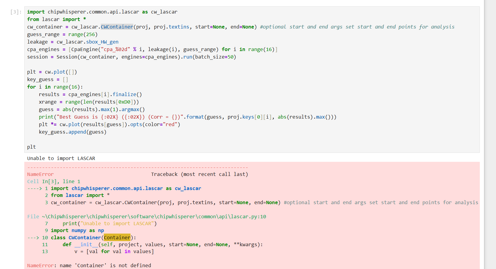

Hello, I’m facing a similar issue in lab 1_1B (SCA201).
When I run these commands:
Thank you,
Nafisa
I couldn’t attach the error picture on other post , here it is:

Unable to import LASCAR, running on windows, I have already install LASCAR and associated library
Hi,
You need to make sure that the python you’re installing LASCAR to is the same one that is running in Jupyter. How have you installed ChipWhisperer?
Alex
Default installation for chipwhisperer, should I move lascar folder under chipwhisperer directory and pip install there?
Do you mean that you used our windows installer? If so, python is used inside a virtual env, so you need to activate that (call \path\to\cwinstall\cwenv\Scripts\activate.bat
) before trying to install LASCAR.
