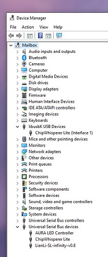

I have read through the forum to see how others solve these issues, but none of the other people’s solution works. I tried updating the firmware, I tried Zadig software to install the latest driver for the chipwhisperer.
This is what I see in my device manager:
