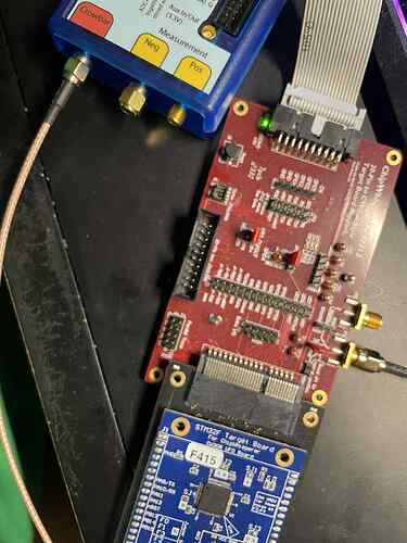

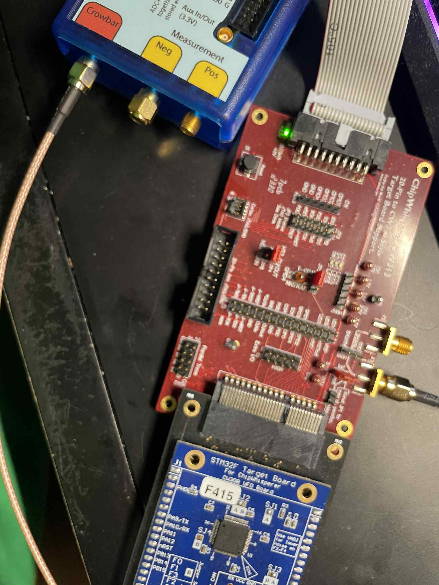

also my setup looks like this( the crowbar is connected to the j3 port) :
i use the CW308_STM32F4 platform.
I dont know whats wrong maybe something on my setup because not only i dont find a successfull glitch but also no reset occurs .
The glitch parameter settings and ranges in the if scope._is_husky: code block are intended for Husky’s standard SAM4S target.
Your STM32F415’s firmware is different, so the glitch settings and timing that are successful on the SAM4S are unlikely to work here. For example, the vulnerable instruction may be executed a few cycles earlier.
I recommend you start with the supported targets first.
I’d also suggest starting with a much narrower glitch parameter range and confirming your target is behaving consistently before running long campaigns. Even small changes in timing or power can make a big difference, so getting a reliable baseline first usually saves a lot of trial and error later.
