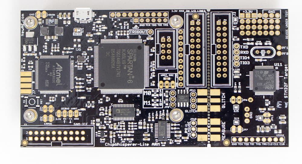

Are you currently using our single-board CW-lite? Like this:
If so, you will need to break the target section and solder connectors, as described here. Then you will be able to connect your CW-lite to the CW308, which must be purchased separately, onto which you can directly connect that STM32F4 target board.
If you are not comfortable with modifying your CW-lite, you can purchase this kit, which has all that you need (except for the STM32F4 which you must still purchase separately): Access to this page has been denied.

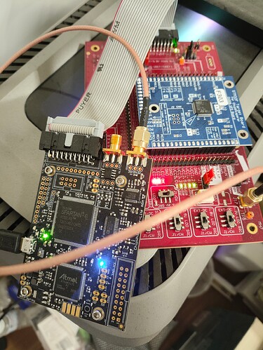

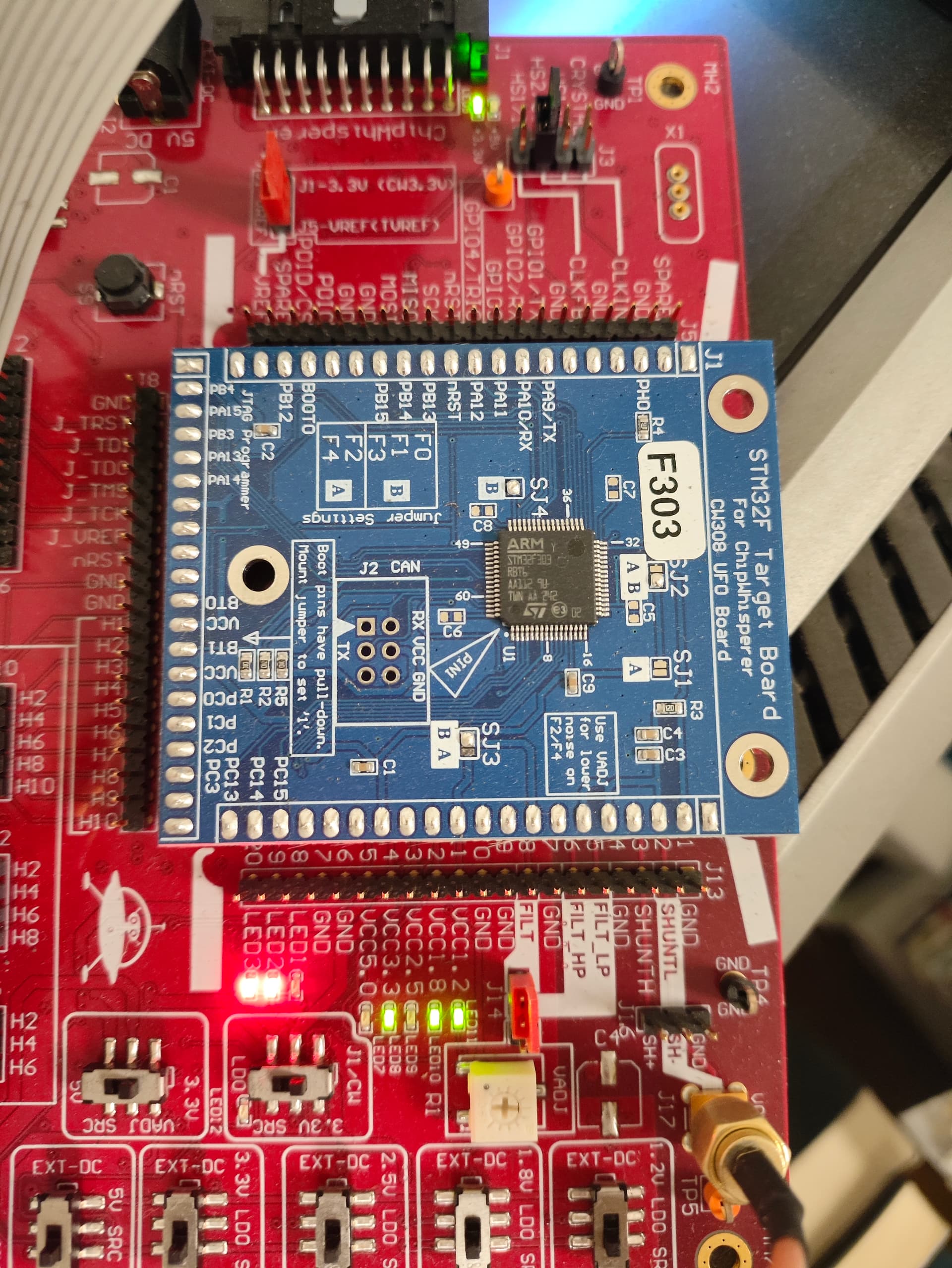

My current settings are below:
I just need to exchange the blue board with my new board(F4)?
Yes, that is correct.
