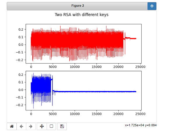

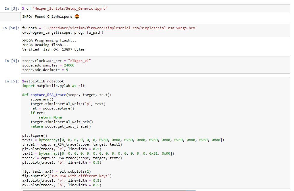

Hi, I’m trying to capture some RSA traces, but with a K-ary exponentiation method. I took the tutorial “PA_SPA_2-RSA_on_XMEGA_8bit” as starting point and got to capture some traces, however I got an error when building:

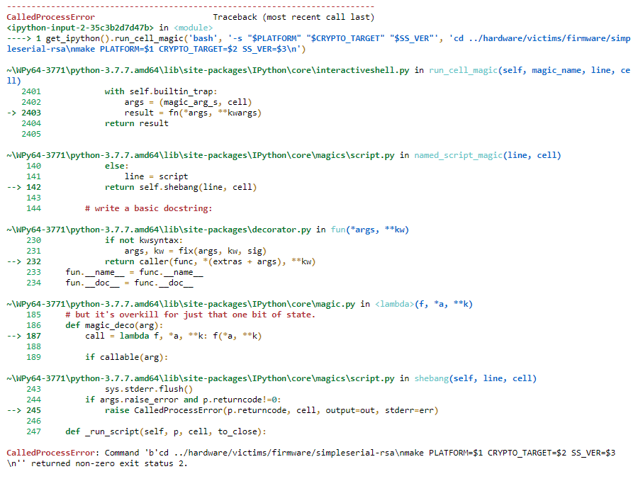

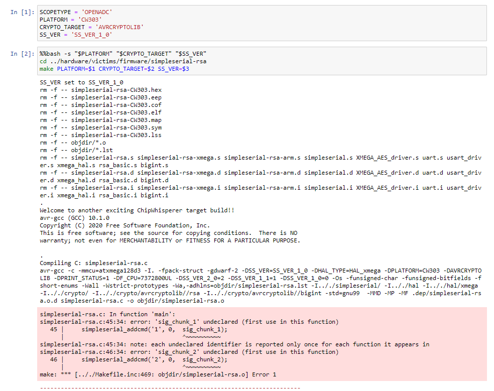

As can be seen in the figures, there is an error when compiling, but the the target is then programmed succesfully. My first questions are: are the obtained traces the right ones? How do I solve the errors shown in the first figure with the undeclared commands “simpleserial_addcmd(‘1’, 0, sig_chunk_1);” and “simpleserial_addcmd(‘2’, 0, sig_chunk_2);”?
