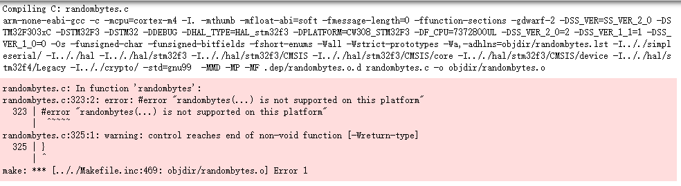

I am using the Chipwhisperer board with Kyber, which is a PQC. I tried the Kyber in VS2019 and found it working well, but when I tried to programming the firmwave, I found some errors which are not seemed in the process of VS2019.
So I guess the reason is that I didn’t define the platform used in this project , but when I try this in VS2019, I didn’t define the platform either. I don’t know how to deal with that and could you tell me which platform I should choose?
BTW, I used Chipwhisperer 5.6 in Windows and here are the source code of randombytes.c:

int randombytes(uint8_t buf, size_t n) {
#if defined(linux)
#if defined(SYS_getrandom)
/ Use getrandom system call /
return randombytes_linux_randombytes_getrandom(buf, n);
#else
/ When we have enough entropy, we can read from /dev/urandom /
return randombytes_linux_randombytes_urandom(buf, n);
#endif
#elif defined(_WIN32)
/ Use windows API */
return randombytes_win32_randombytes(buf, n);
#else
#error “randombytes(…) is not supported on this platform”
#endif
