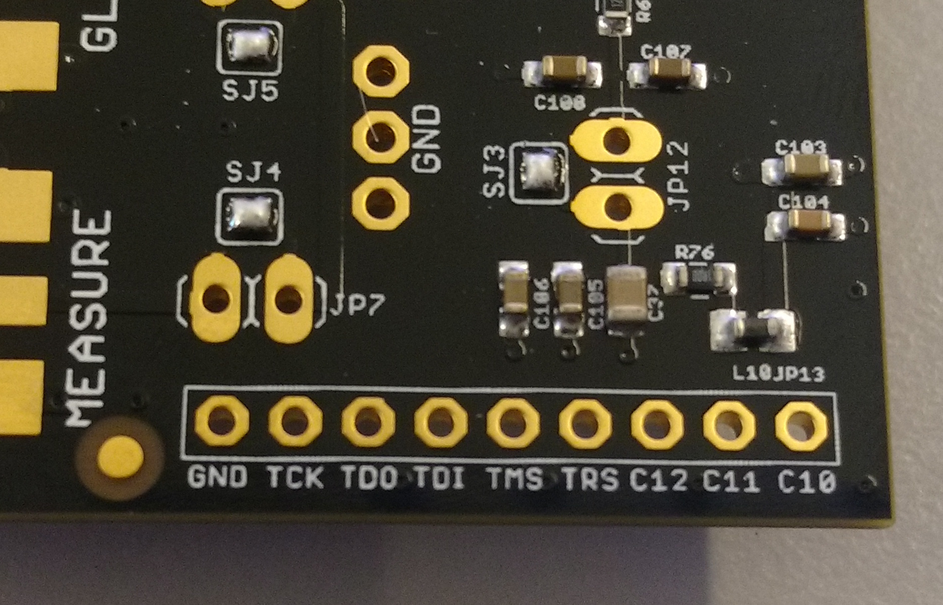

is it possible to attach an ST Link adapter to the Chipwihsperer Lite ARM?

I have done that by attaching ST-link on the bottom header of the target:
Then I used the st-flash tool to flash the firmware:
st-flash --reset --format ihex write glitchsimple-CWLITEARM.hex
I hope it helped.
