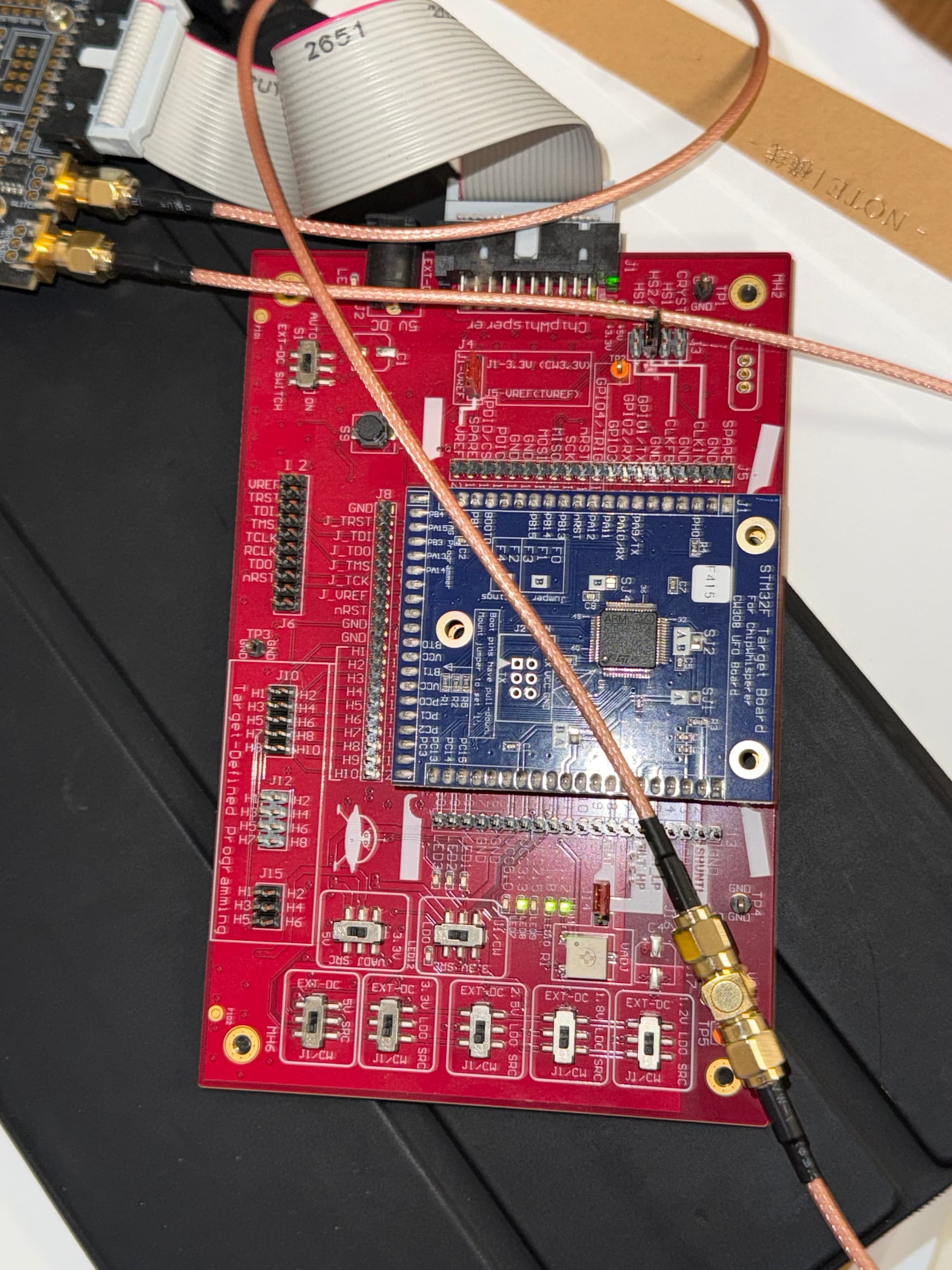

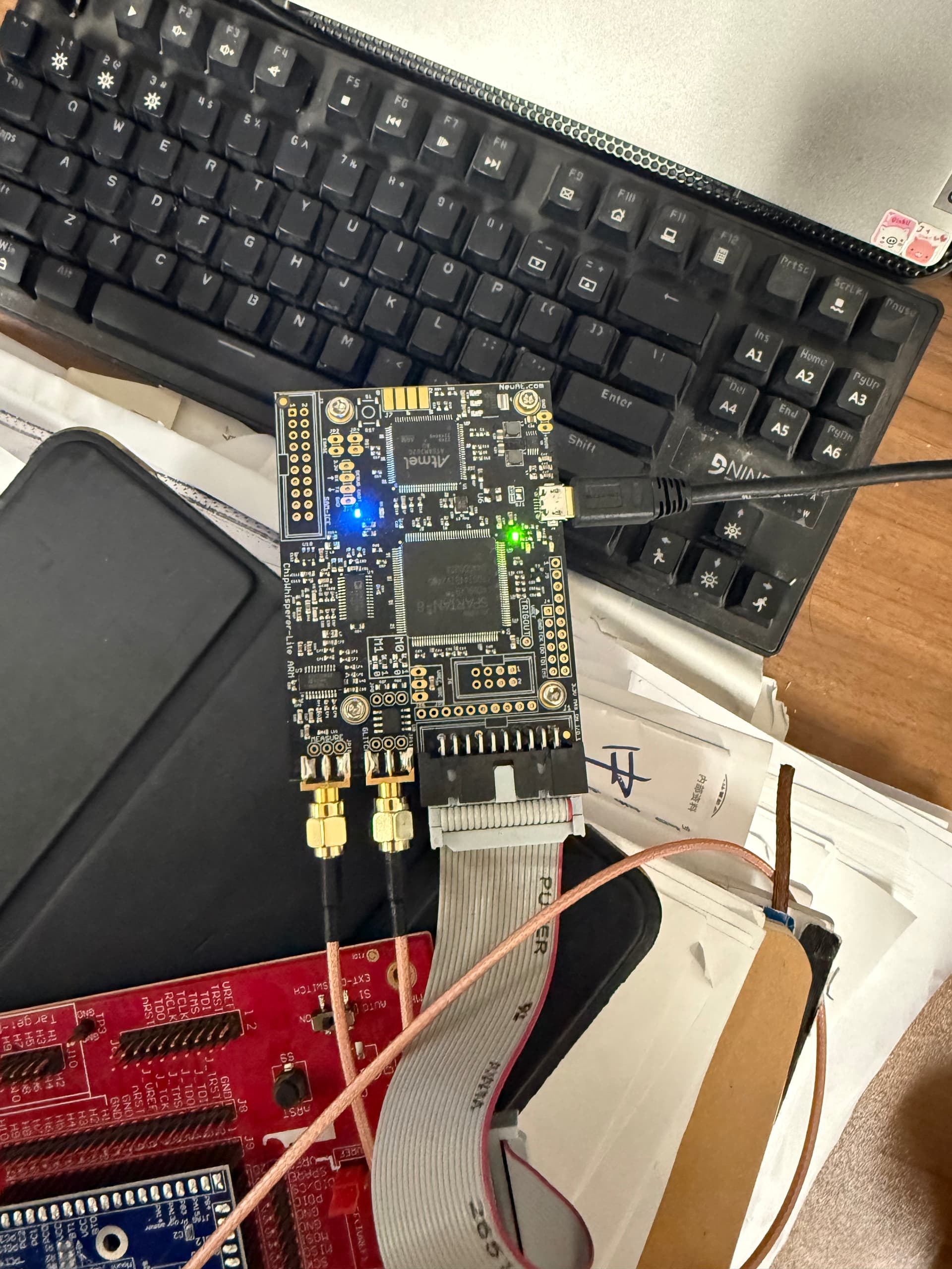

My Setup:
  • ChipWhisperer model: CW-Lite
  • Target board: CW308 UFO + STM32F4
I would greatly appreciate any guidance on proper F4 configuration or troubleshooting steps to restore reset functionality.

As noted here, the F4 has an internal voltage regulator.
This makes voltage glitching much harder.
Is clock glitching just as hard for stm32f4 because of some hardware reason?
For clock glitching, what matters is whether the target uses the supplied clock directly, or whether it goes through a PLL (which is usually very effective at filtering glitches), or whether the target uses an internally-generated clock. Our STM32 build system supports both internal and external clocks (see here).
You’ll find that in fault101, labs 1.2, 1.3, 1.4, and 2.4 have recommended glitch settings for the F4.
