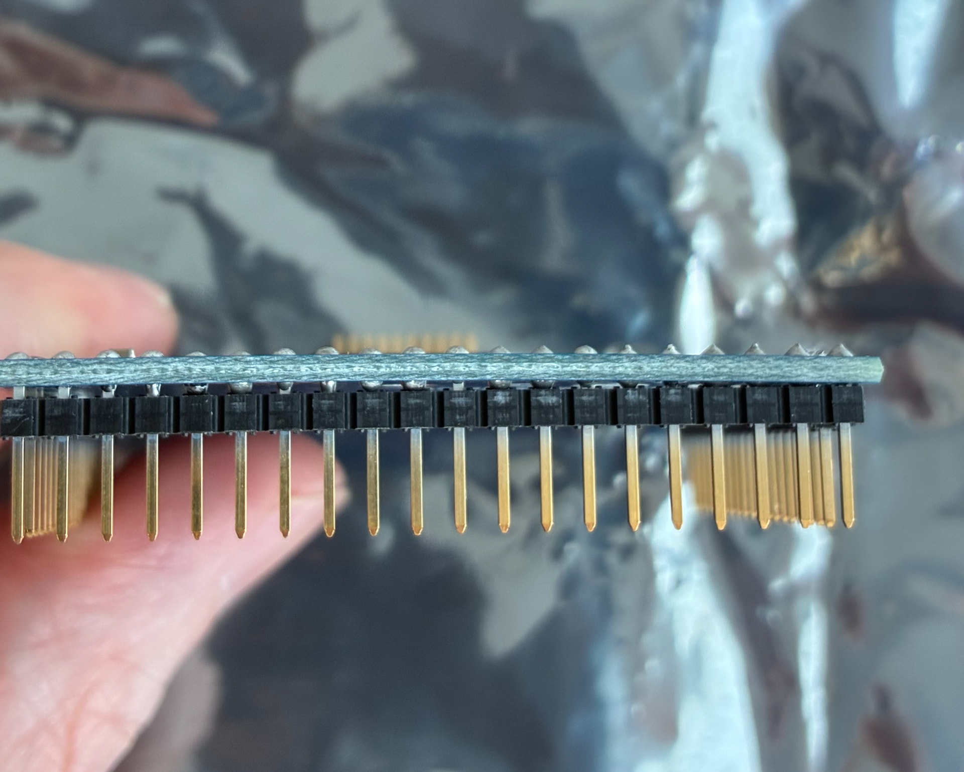

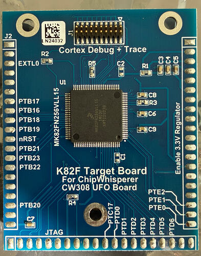

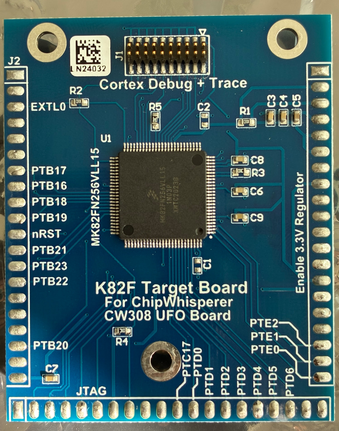

I have just received the CW308 K82 target board and a bit surprised by product quality.
I purchased many NewAE products before but all they were perfectly made. This time it looks like unusually.

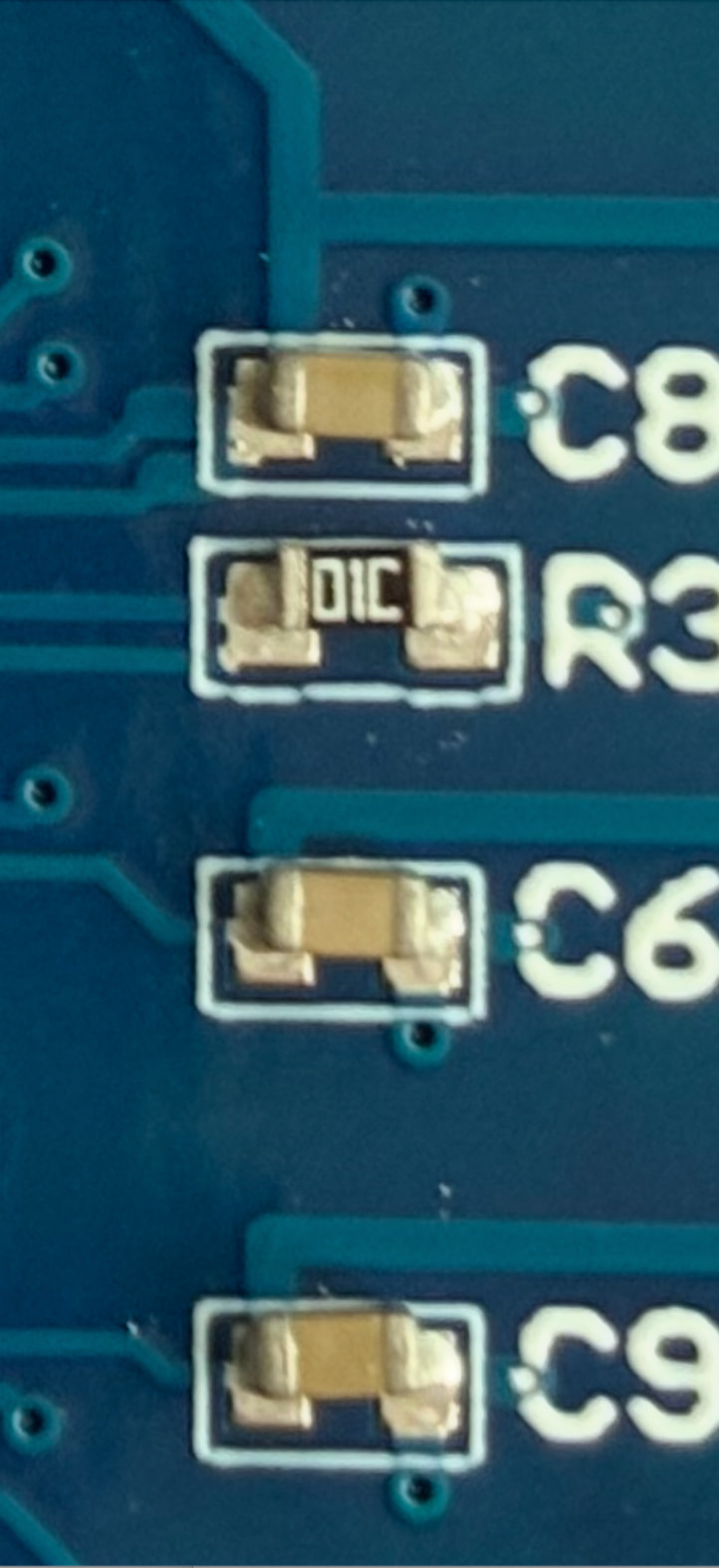

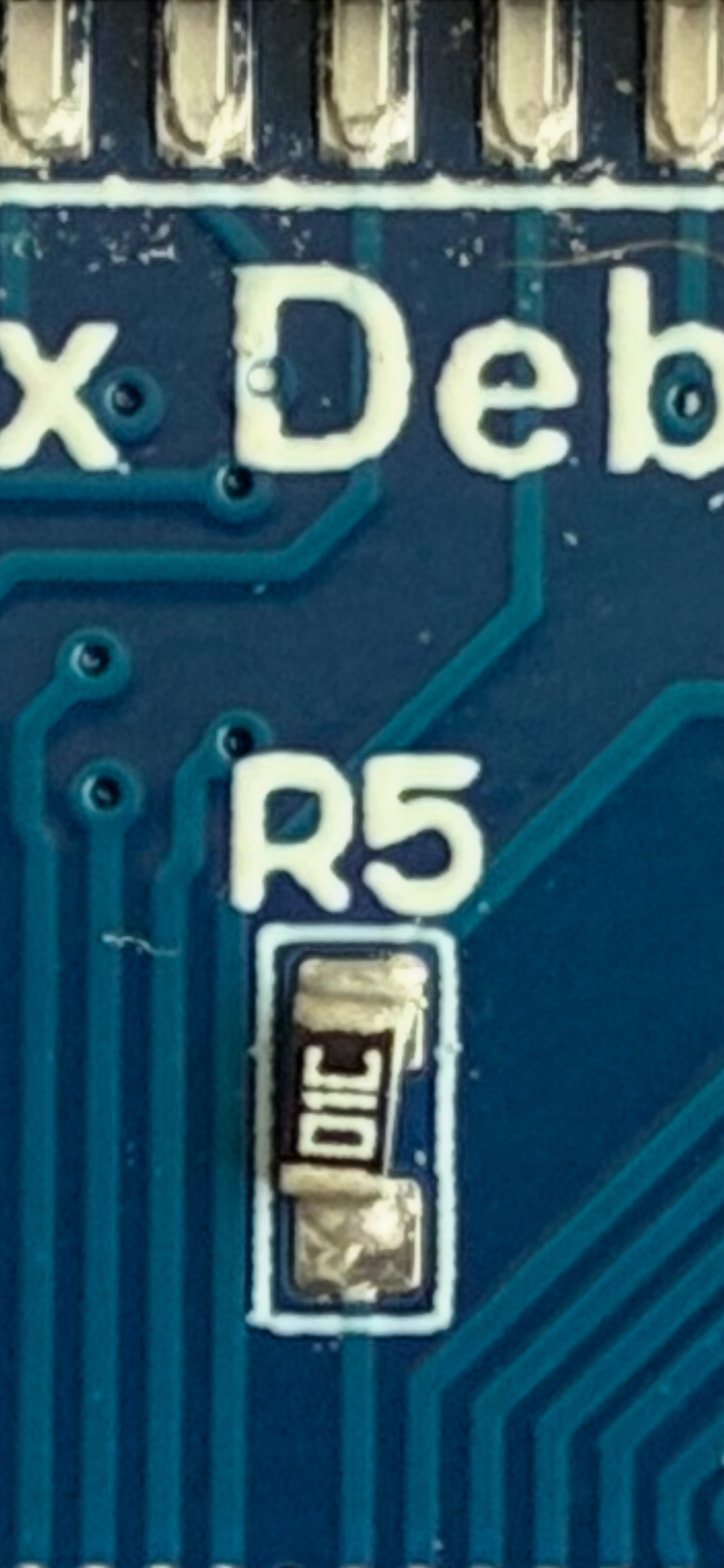

  1. SMD components are not aligned
  2. HASL is used instead of ENIG
  3. Solder quality itself is not perfect
  4. Header pins are misaligned
The board was bought at Mouser.
…more observations.

While some boards have used HASL recently, ENIG does remain our standard.
I agree that the alignment doesn’t look great, but all our products undergo functional testing before they go out; let us know if you run into any issues with it.
