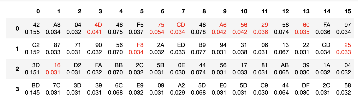

I did some work to confirm the Shannon theorem pattern is applicable very well for the SCA attack.
…regarding the question about the frequency of the CPU core of STM32F415RGT6 used by the ‘simpleserial’ application.
The system core clock is calculated as SystemCoreClock = ((INPUT_CLOCK (HSE_OR_HSI_IN_HZ) / PLL_M) * PLL_N) / PLL_P
from hal/stm32f4/stm32f4_hal.c, we have
RCC_OscInitStruct.PLL.PLLM = 12; // Internal clock is 16MHz
RCC_OscInitStruct.PLL.PLLN = 196;
RCC_OscInitStruct.PLL.PLLP = RCC_PLLP_DIV4;
SystemCoreClock = ((7370000 / 12) * 196) / 4 = 30 094 166 Hz
The lab uses the clock source for the ADC module scope.clock.adc_src = "clkgen_x4"
which is 7370000 * 4 = 29 480 000 Samples per second.
We can see that the sampling rate of the CW Lite is almost equal to the system core of STM32F415RGT6.
To confirm the Shannon theorem pattern for the SCA, we can just change scope.clock.adc_src = "clkgen_x4"
on scope.clock.adc_src = "clkgen_x1"
In this case we get 4 times less sampling rate than the target CPU core frequency (7 370 000 samples per second against 30 094 166 Hz of CPU core).
Below are the pictures which reveal how reliability of recovering of the last round key was changed
It proves that the limit of CW devices to run the SCA attack is close to the sampling rate limit.
So CW Lite has reliable work when the target devices is driven by the clock up to 100 Mhz.
The CW Husky up to 200 Mhz.
But I believe it very depends of the HW crypto IP implementation (how many rounds are executed per a clock cycle).
Have you tried the attacks with larger number of power traces? I think it is possible to attack on underdamping SCA data, but we need more power traces.
