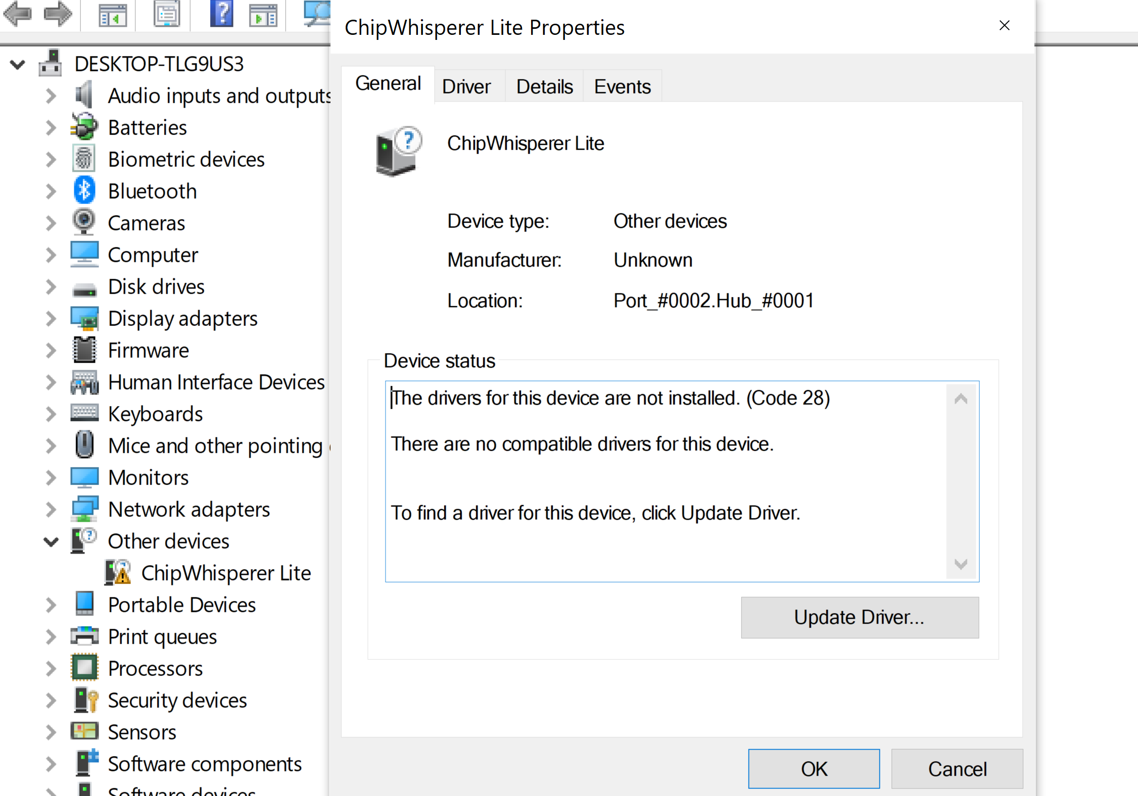

Hello,
This looks to be a very similar issue to the problem from earlier this month with CW305 (Chip Whisperer Lite, with the XMEGA-128 chip) - see below.
NameError: name ‘scope’ is not defined
We cannot see our scope, when we run it in Juypter Notebooks. I think we need to update our firmware on either the CW or the target board.
What I would like to know is:
  1. Should we use Single Step Firmware Flashing?
  2. Should we Zadig?
I’d recommend using Zadig to install drivers temporarily, then using the single step update: https://chipwhisperer.readthedocs.io/en/latest/firmware.html#single-step-update.
Basically, you just use Zadig to install WinUSB drivers for your Lite, then you can run the auto update code (there’s also a Notebook called ChipWhisperer Firmware Upgrade.ipynb).

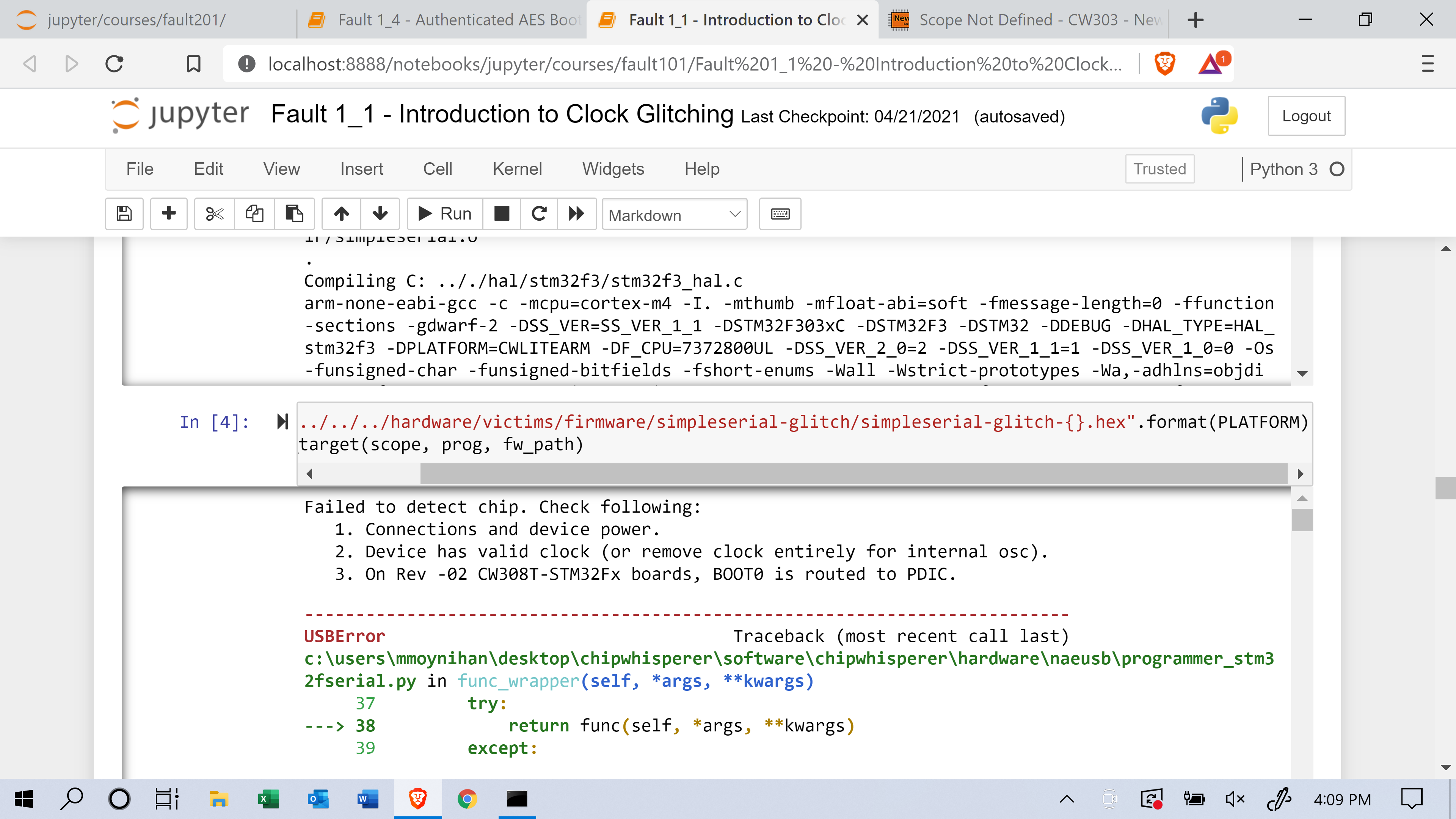

We fixed that issue. We insalled the ARM compiler, but we got a failed to detect chip. More specifically, a USBError.
Alex,
So we restarted and the Fault 101 “Introduction to Clock Glitching” lab simply hangs on that command. It says right there in the lab:
“If in the course of following this tutorial you find the FPGA appears to stop responding (i.e. certain features no longer work correctly), it could be the partial reconfiguration data is incorrect.”
It Hanged for about 20 minutes. We have the 303 Lite Kit.
Is there another lab that would be better suited for the 303 Lite?
Try switching to PLATFORM="CW308_XMEGA" at the beginning of the Notebook and restarting.
